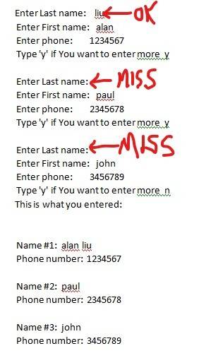

I have something I cannot fix in this program. Also I don't know how to test EOF in vector to jump out of do-while loop.
Code:

I try to enter 3 names. The first time ran ok, but it will skip asking the Last Name on the 2nd and 3rd name and you can see in the image of output captured. Somehow the program skip line22 the second and third time. I cannot figure this out as it's inside the do-while loop, why it work only the first go around?
Also, if you look at line39, I put a 3 to stop the loop. I really want to have a way to detect the EOF of the vector to stop the do-while loop. I cannot find this in the book. Please advice what can I do as this is only an experiment program. In my real program, I want to put in different number of names and I need to detect EOF to stop the operation. I don't know how to push_back an EOF to the last element of the vector array.

Vanadium 50 said:
What is in the input buffer after line 29?
Why do you think I asked this? And why do you think ignoring it is the best way forward?
I don't know, like I said, this program is way beyond what the book covered, I am winging it as I need a scalable size array of structure and class object. I am looking into vector(sizable), pointer to allocate memory or fstream file. So I am looking deeper into vector first to see whether it can fulfill what I need. I try not to use fstream file as I plan to not only scale the size, I will perform sorting in the future. I don't want to run the flash or HD doing that. I much rather do all the sizing and sorting with vector array or allocated memory first, then store it one time into file.
That leaves vector as the most apparent choice as it's scalable.
I don't know what you are looking for the buffer after line 29, the only buffer is Directory Info which is the temporary structure object to store the info to be push_back into the vector. It's not being used after line 29. I assume it contains the info of the 3rd element. Like I said, when I read back from the vector array IVar, I read all 3 elements of structure Directory out correctly. I am not ignoring anything.
This has nothing whatsoever to do with vector. I don't why you keep insisting it does. After all, you don't know what your code is doing wrong, so how can you be sure where the problem is?
I mean the input buffer. When you ask the user to type y if they want to enter more, what is in the input buffer after they type 'y'?
Hint #1: it's not 'y'
Hint #2: How many keystrokes does the user enter?
Hint #3: The answer to #2 is not "1".
Likes yungman

Thanks I got it, I need to put cin.ignore() after line 29.
Speaking of cin.ignore(), I did put that right after line20, the program hung. I know that has something to do with the fact there is no cin >> before that. But why the program got hung?
