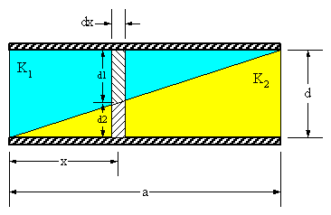

For a parallel plate capacitor, Capacitance C=KεoA/d
A is area of plate and d is distance between the two plates..
I do not know how to approach. I divided the capacitor along the diagonal into two halves. For the first half,
dC1 = K1εodA/dl
I took a strip of edge dx and length "l" perpendicular to the capacitor. Area of that strip= (x+dx)2-x2=2xdx..
dA=2xdx
Hence,
dC1 = 2K1εoxdx/dl
Now taking an angle θ, tanθ=d/a= (d-l)/(a-x)...
Am I going in the right direction ?
Please help !
Thanks in advance...
:smile:
I can't clearly picture how you're dividing up the device. In my mind's eye I can see taking vertical slices of width dx across the image. At some horizontal position x, a slice will effectively consist of two capacitors in series, one with dielectric K1, the other with dielectric K2. "Plate" area is given by a*dx, and "plate" separation for each capacitor can be determined with a bit of geometry.
Ok, So I have a differential form,
dC2=K2εoadx/distance, as per the hint you gave. I also understand that the two capacitors are in series. So what should I replace K with ?
And about geometry... I took angle θ between diagonal and an edge. Then,
tanθ = d/a = y/x = (d-y)/(a-x)
where, the capacitor with dielectric constant K2 is positioned at distance x and its distance from the one edge(horizontal) to the boundary of second capacitor.

You don't replace K, rather you need to find expressions for the two capacitors in terms of their individual K's and geometry, then combine them in series to yield a net capacitance for that "slice". The slices are all in parallel...

I believe so... can you write expressions for the two capacitances of a slice?
gneill,
As per the image you gave,
dC1 = K1εoadx/d1
dC2= K2εoadx/d2
Correct ?
Now dC=dC1*dC2/(dC2+dC1) ?
sankalpmittal said:
gneill,
dC1 = K1εoadx/d1
dC2= K2εoadx/d2
Correct ?
Right. You'll want to express d1 and d2 in terms of some common variable over which you can integrate.
Ok, so replacing d2=d-d1,
dC1 = K1εoadx/d1
dC2= K2εoadx/(d-d1)
Now, dC=dC1*dC2/(dC2+dC1)
dC=K1K2εoadx/{K1(d-d1)+K2d1}
Now to what limit shall I integrate this expression over ? Looks like I will have to eliminate d1.
By geometry, I got,
d(a-x)/a = d1
Correct ?
P.S. d is distance between plates as given. dC is small capacitance. dx is small distance between slices as per your image. (Thanks.)
By geometry, I got,
d(a-x)/a = d1
Correct ?
Sure. So you're integrating w.r.t. x. You should be able to see from the diagram the limits for x.
Thanks a lot gneill ! :smile:
I integrated the expression in limits of x from zero to "a" and got the correct answer ! Thanks once again.
