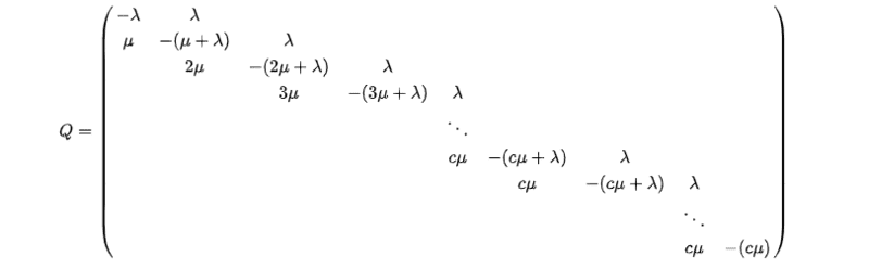

What is the generator matrix (Q) for a system of M/M/2/2? What about for M/M/2/4?
My attempt: I know what is it for M/M/2/4 given that K > C (just included it to explain what I am exactly after), but is there any way to have a canonical form of the generator matrix for M/M/C/C such as M/M/2/2? Any help would be appreciate it.

CTK said:
I know what is it for M/M/2/4.
Can you show what this is? I don't understand why you have a difficulty using the same logic for M/M/2/2.
So for M/M/2/4 it is simply Erlang-C model because c is not equal to k (I have attached a picture of that, which is just from Wikipedia). But when we are dealing with M/M/2/2 then here c = k, so we are dealing with Erlang-B model, and I couldn't find anything about Erlang-B model's canonical form matrix anywhere. So any help would be appreciate it.

  • How many rows does the M/M/2/2 matrix have?
  • Do you think there is any reason the first, second and third rows should be different from the one in Wikipedia?
  • What do you think the last row should look like?
1-) Would the matrix just be 4x4?
2-) In my opinion, all of the matrix in Wikipedia should still be exactly the same for all of the rows even if k = c, is that correct?
3-) I think it would still look like the same, am I right?
Edit: this is wrong, I will replace with another post.
1 - Yes
2 - The first two rows are the same, but the coefficient of 3 in the third row assumes 3 servers so cannot be right.
3 - Yes

pbuk said:
1 - Yes
3 - Yes
2-) But the coefficient of 3 doesn't take place in the third row, but fourth row.
Sorry, I gave wrong answers to this before.
1-) No, there are five states (with ## {0, 1, 2, 3 \text{ or } 4} ## customers in the system).
2-) No, there are only ## c ## processors so the maximum coefficient of ## \mu ## appearing in the matrix must be ## c ##.
3-) Yes, the last row is the same.
1-) No, there are five states (with ## {0, 1, 2, 3 \text{or} 4} ## customers in the system).
3-) Yes, the last row is the same.You can't, you need to work from first principles.
