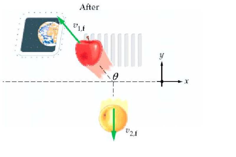

Can someone tell me why there is no initial momentum when these 2 objects collide in the y direction?
At first these objects were going in the x direction this picture shows what happens when the objects collided.
Apple Orange
that is what it would look like when the objects going in x direction

Your wording is a bit confusing here. Do you mean that there is no initial momentum in the y-direction, or that there is no initial momentum, period?
If the former, the answer is simple -- there is no initial momentum in the y-direction because, initially, both objects are traveling solely in the x-direction.
If both objects have velocity components only along the x-axis, then there are no velocity components in the y-direction (or rather, their y-components are zero), hence no momentum in the y-direction.

It's just what both gneill and I said before. Before the collision, the objects aren't moving in the y-direction, therefore, neither of them has any momentum in that direction.
Yes, It turned out I was a little confused with the pictures. I have another question that was stated above your post.
It should go something like this:
sum of momenta before = sum of momenta after.
Applying this separately in the x and y-directions you get:
y-direction ( (1) for apple, (2) for orange, i for initial, f for final):
0 = p(1)f,y + p(2)f,y
p(1)f,y = -p(2)f,y
x-direction:
p(1)i,x + p(2)i,x= p(1)f,x + p(2)f,x
