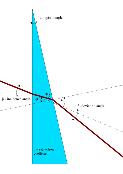

I don't understand whether the angle of deviation depends on a the angle of incidence in a thin prism or not?
Is the thin prism always in the position of minimum deviation?
If you want to get understanding (rather than get ready answer to simplified yes/no question) - compute it yourself.
Compute what is deviation angle as a function of angle of incidence and apical angle, then make several plots (for several apical angles, e.g. 10°, 20°, 30°, 45°): deviation angle as a function of angle of incidence. And compare the plots.
That's pretty easy calculation. You know Snell's law. You can do it yourself! Yes, you can!
You are right,I already tried something like that,but I failed .I always get different angles of deviation for different angles of incidence,and this should not happen,because we study that the angle of deviation in a thin prism isn't affected by the angle of incidence.
Please, post the plots you made and formulae you got - I'll try to point out what you did wrong.

I've put my work as you told me,so could you tell me what's wrong with it?
First graph looks reasonably, the second is totally wrong - check calculations (the calculator may help)
You should find first the formula describing the deflection angle as a function of incidence angle and apical angle, then make several graphs of this formula for various fixed values of apical angle.

Derive a general formula, describing the deflection angle as the function of two parameters: apical angle and incidence angle.
Derivation is pretty easy. You must just draw a picture, give names (symbols, rather than actual values in degrees) to all angles, then combine and reduce several simple trigonometrical formulae.

Make a drawing how the ray passes through a prism. Something like in your first post. Mark all angles and give them symbols. Write down Snell's relations between incidence/refraction angles on both surfaces, using n as refraction index. Express all angles as sums/differences of: apical angle, incident angle on first surface, deflection angle.Transform those equations to have it in form:
deflection_angle = some_function_of(incident_angle, apical_angle, n)
Make graphs of that function for several fixed values of apical_angle and single example value of n
Compare those graphs visually and find some regularity of the graph shapes - it will be obvious as you look at the graphs.

Yes. Sorry for wrong terminology. The angle between final ray and incoming one.

You may chose any convention of signs you like.
I see you got lost in it. A little help from my side - I spent 10mins to make a readable drawing:
In this convention your equation is:[tex]\delta=\theta-\beta-\alpha[/tex]
but while making some calculations I found that's not true-it gives me a negative value for the angle
Please stay with naming and sign convention as on this drawing (angles are positive if they are like on the drawing, negative if they lay on opposide side of the normal to the surface), if you prefer other names and other sign convention - it is ok, but post a readable drawing.
but according to this drawing
deviation=emergence-incidence+apical
not deviation=emergence-incidence-apical
oh sorry you are right

Check if you derived your formula for deviation from Snell's law correctly.
Show me your formula of defiation_angle(incidence_angle, apical_angle, n) - if you want me to check it.
Make such drawings not only for angles 0-40 deg, but for a range -40 - 40 deg
and make such drawings for several apical angles (e.g. 5, 10, 15, 20, 25, 30 deg)

The sequence you use is ok, but apparently you did something wrong in any of those steps, because the numbers you got are wrong.
Show me the final formula you use for: [itex]\delta[/itex] as a function [itex]\delta(\beta, \alpha, {\rm{n}})[/itex].

No. I won't do it for you. If you want to learn something - you must do some calculations yourself. I've already made a sketch for you - which was easy enough that you could do it yourself.
Put a little your own effort to find an answer to your question!
Ready answers from others won't teach you nothing. Do it yourself.
