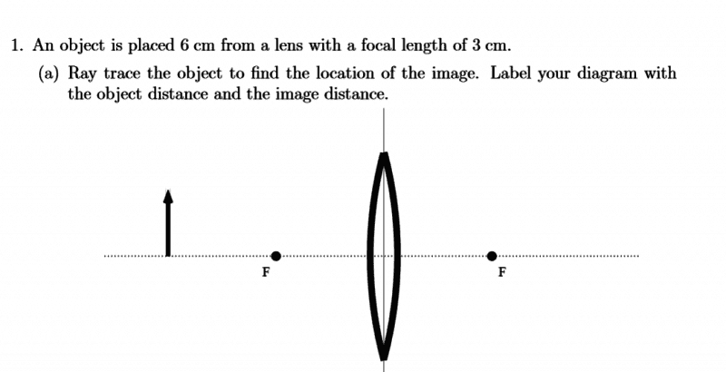

B) Is the image real or virtual? Explain.
C) Using the lens equation, find the image distance.
2. Homework Equations
1/di + 1/do = 1/f
A)
B) The image is real because it is on the opposite side of the lens as the source of light.
C) do = 6cm f = 3cm
1/do + 1/di = 1/f
1/di = 1/f - 1/do
1/di = do/f(do) - f/f(do)
1/di = (do-f)/(f*do)
di = (f*do)/(do-f) = (3cm * 6cm)/(6cm - 3cm) = (18cm^2)/(3cm) = 6cm
di = 6cm

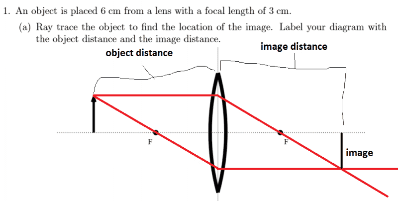

not too confident about my ray tracing. this is what it shows in the book but i know it differs depending on the situation
Your ray tracing is all right. The ray entering parallel with the axis goes through the focus on the other side of the lens.
The ray entering through the focus, goes parallel with the axis on the other side.
Likes toothpaste666
ok i feel a little more confident that i got both of these problems right. thanks for the help
you are welcome.:)
