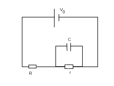

Given a circuit with two resistors, R and r, and a capacitor of C, and EMF of V0 as shown in the diagram, find the voltage across the capacitor during charging. Prove that this voltage, V is given by V = V0 (r/(R+r)) (1-e-((R+r)t)/(RrC))
N.A.
This is what I have
Loop A (with C): V0 + RI + q/c = 0 ==> I = (V0 - VC)/R
Loop B (with r): V0 + RI + rIr = 0
I = Ir + Ic ==> I = V/r + C(dv/dt)
From first and third,
(V0 - VC)/R = V/r + C(dv/dt)
Simplify to get,
V0 - RC(dv/dt) = V(1+R/r)
V = (r/[R+r])(V0 - RC(dV/dt))
The shape of the equation is getting there (I hope), but what do I do next? To get the given equation, RC(dV/dt) must be V0e-((R+r)t)/(RrC).
RC (dV/dt) = V, solving this differential equation to get ln (V) = -t/(RC) + k, hence, RC (dV/dt) = e-t/(RC) + k. And I am totally stuck.
Did I do something wrong somewhere? I can't think of anyway to get the RrC term in e-((R+r)t)/(RrC), not to mention the V0 and the (R+r) terms, unless k is like Rt/r. But that still does not give me a V0?

The differential equation is correct. You need not solve it to prove that the given V is solution, just plug in V and dV/dt. What is the derivative of the given V(t) function? ehild

NO.
Your differential equation is not V = RC (dV/dt), but V = (r/[R+r])(V0 - RC(dV/dt)).
ehild

That will get me
(V - (r/[R+r])V0)-1dV = [-(r/[R+r])RC)]-1dt
Which gets me ln [V - (r/[R+r])V0)] = t/(RrC/[R+r])
V - (r/[R+r])V0) = e(t/(RrC/[R+r])]
And a little rearranging gets me V = e(t/(RrC/[R+r])] + (r/[R+r])V0)

ProjectENIS said:
Sorry for the mistake,
That will get me
You missed to add the arbitrary constant. Your result will be is the same as the given function with the condition that the initial voltage on the capacitor is zero: V(0)=0.

Why do you substitute V=RC(dV/dt)? It is valid for a simple RC circuit only.
ehild
Hi again ehild, I added in the arbitrary constant and got the equation! Thank you so much!
Regarding the V = RC (dV/dt), I have misunderstood the derivation, and assumed that it is a general formula for all RC circuits. Thanks for pointing that out, I'll read up on it tonight.
