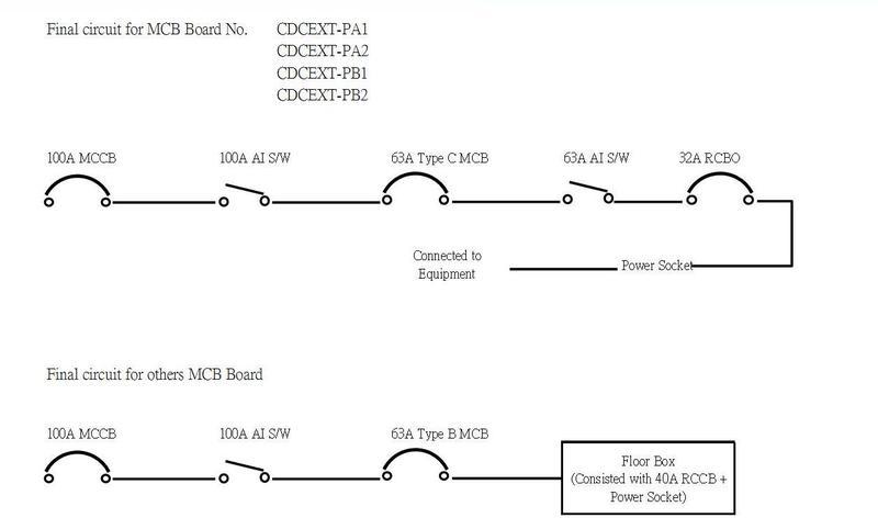

Hi, I got a problem and seeking for help, could anyone do me a favor.
The power supply of network data centre is supplied by a UPS. The UPS’s output connects to 2 nos. of 800A MCCB individually. And the circuits are protected by:
( Form >> to )
A) 800A MCCB >> 100A MCCB >> 100A AI switch >> ( circuit 1 & 2 )
1) 63A Type C MCB >> 63A AI switch >> 32A RCBO >> Power socket
2) 63A Type B MCB >> Floor box (40A RCCB + Power socket)
B) 800A MCCB >> 100A MCCB >> 100A AI switch >> 63A Type B MCB >> Floor box (40A RCCB + Power socket)
The case is that, a fault occurred at data server that supply by the power socket of circuit A(1). The 32A RCBO was tripped. When I tried to reset the RCBO, it tripped again immediately. At the mean time, an unpredictable scenario was happened. Some RCCB (around 6 nos.) at circuit A(2) and circuit B were tripped at the same time immediately. That caused around 7 nos. of servers were downed. Could anyone do me a favor to give a hint? Thanks you so much.

No MCCB or MCB was tripped, only the the RCCBs were affected. That caused around 7 nos. of servers downed. Finally, a fault equipment at circuit A(1) had been isolated, and all circuits had been reset. My question is that ;
1) Why the other RCCBs at the final circuit of the separated circuits were tripped during I reset aforesaid RCBO?
2) How the fault affect separated circuits?

well, in your 'attached thumbnail' i see where the faulted equipment was connected.
but i do not see anything labelled "RCCB" , just a note below "floor box".
Where are the RCCB's that tripped when you tried to reset?
Can i assume it was "32A RCBO " in lower right that you tried to reset?
What's difference between a 32ARCBO and a 40ARCCB?

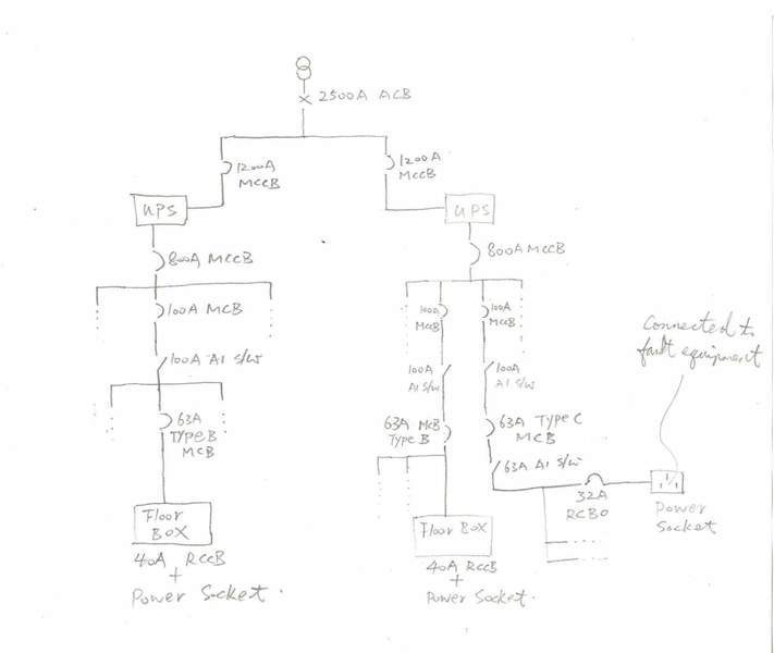

There are RCBO's in only one out of seven 100A branches ? (in all others - RCCB's ?)
At first I would checked for loose connections everywhere - up to the 2500A ACB.

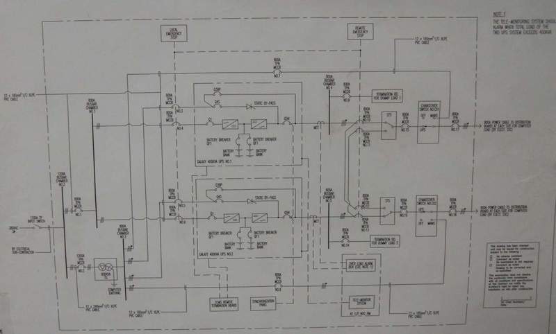

Further circuit diagrams are attached for reference. Thank you so much.

thanks for those diagrams.
wow- to me 400 kva is a big inverter. I'm accustomed to 20KVA and smaller.
I'll assume one that big is three phase. Looks like it in drawing.
you said: ""..only the the RCCBs were affected...""
only the 'residual current circuit breakers'... well that suggests (but does not prove) current in the earthing conductors...
which brings up two more questions:
what did you find in that faulted piece of equipment? Was the short circuit between hot line and earth, or between hot and neutral?
and
Are these RCCB's single or three phase? Are you servers powered line to neutral or line to line?
For a line to line or line to neutral fault , '32A RCBO' should have tripped on its overcurrent sensor not on residual current. For a line to earh fault it should have tripped on its residual current sensor, which trips at a much lower current.
So next question is - " How much current does your server power supply allow to return through its earthing conductor in normal operation? "
That depends on its internal capacitance, and most of that is likely in a "line filter" or a surge protector.
Can you make a test power cord with an ammeter in the earthing conductor and measure that return current? Shouild be in low milliamp range, or high microamp.. Compare that to the residual trip setting of your RCBO's. If it's a surprise and close to your setting, you may want to reconsider how they're set.
Just perusing literature i see typical settings between 3 and 500 milliamps.
The next question will be "How much current does your server power supply allow to return through earthing conductor under abnormal conditions? "
but that one will take some thnking and probably some testing to figure out..
