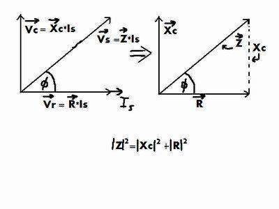

b) Calculate the magnitude of the combined impedance of the capacitor C1 in series with R1.
so Z total= Zr1+Zc1?
Z total = 14kOhm?

a) is correct. d) is correct except you got the wrong value of Ic.
b) Not quite. If you draw a vector diagram of the voltages in the circuit you will have something like this:
Code:
|/____
Where the vertical vector is the voltage of the capacitor, the horizontal vector is the voltage of the resistor and the diagonal vector, which represents the vector addition of the other two, is the voltage of the source. Thanks to Ohm's law you can divide the magnitude of those vectors by I, which is the current throughout the circuit (it's the same for all components). Now the orthogonal vectors represent the impedance of the capacitor and the resistance of the resistor and the last vector represents the impedance of the whole circuit, which is what you are looking to find. Through Pythagoras you see that Z2 = Xc2 + R2 and from here you find Z (10kOhm).
c) VRMS = IRMSZ. You have both VRMS and Z, so you can see how IRMS = 0.3mA.
Sorry for the crude drawing, I'm not on my main computer right now.
