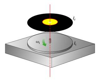

Consider a turntable to be a circular disk of moment of inertia I_t rotating at a constant angular velocity w_i around an axis through the center and perpendicular to the plane of the disk (the disk's "primary axis of symmetry"). The axis of the disk is vertical and the disk is supported by frictionless bearings. The motor of the turntable is off, so there is no external torque being applied to the axis.
Another disk (a record) is dropped onto the first such that it lands coaxially (the axes coincide). The moment of inertia of the record is I_r. The initial angular velocity of the second disk is zero.
There is friction between the two disks.
After this "rotational collision," the disks will eventually rotate with the same angular velocity.
(a)Because of friction, rotational kinetic energy is not conserved while the disks' surfaces slip over each other. What is the final rotational kinetic energy, K_f, of the two spinning disks?
Express the final kinetic energy in terms of I_t, I_r , and K_i the initial kinetic energy of the two-disk system. No angular velocities should appear in your answer.
(b)Assume that the turntable deccelerated during time [tex]\Delta[/tex]t before reaching the final angular velocity ([tex]\Delta[/tex]t is the time interval between the moment when the top disk is dropped and the time that the disks begin to spin at the same angular velocity). What was the average torque,[tex]\tau[/tex] , acting on the bottom disk due to friction with the record?

You don't need delta K, you just need to express K_f in terms of K_i and the other variables. First find w_f. You'd do that just like you did in that similar problem the other day. Once you find w_f, then worry about finding K_f and expressing it the way they want it. (It will take a little algebraic rearranging, that's all.)

First thing, why do you need delta K? Neither it has been asked, nor it appears in the two equations you have quoted!
You need Kf in terms of It, Ir and Ki. In the above two equations, you have two unknowns, wf and wi. To get a required condition, you need just one more equation. So, somehow try to relate wf and wi.
Hint: You know some conservation laws, right?
Substitute unwanted wi in terms of Ki.
(K_i * I_t) / (I_t + I_r) ---> i believe this is correct...Now onto the second part...

part (b) solved:
w_f = w_i - [tex]\alpha[/tex]*[tex]\Delta[/tex]t --->
-[tex]\alpha[/tex] = (w_f - w_i) / [tex]\Delta[/tex]t --->
[tex]\tau[/tex] = I*[tex]\alpha[/tex] --->
[tex]\tau[/tex] = I[tex]^{t}[/tex] * (w_f - w_i) / [tex]\Delta[/tex]t

Good! Realize that this is just the angular form of impulse. Just like linear impulse equals change in linear momentum, angular impulse equals change in angular momentum:
[tex]\tau \Delta t = \Delta L = I \Delta \omega[/tex]
