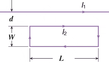

In summary, a rectangular current loop with dimensions L=0.40 m and W=0.19 m is placed near a long, straight wire (d=0.10 m) with a current of 10 A. The current in the loop is 20 A. Using the formula F=IlB, we can find the net magnetic force acting on the loop by considering the forces on the longer sides of the rectangle, as the forces on the shorter sides cancel each other out. The attached drawing would provide further clarification.
figs
27
A rectangular current loop (L=0.40 m and W=0.19 m) is located near a long, straight wire (d=0.10) that carries a current of 10 A (see the drawing). The current in the loop is 20 A. The Determine the magnitude of the net magnetic force that acts on the loop.
i was chugging my B from the wire into f=IlB
We don't have the drawing (couldn't u attach it ?).It would make much difference how the straight conducting wire would be located wrt the rectangle...

oops, sorry!
You are using the correct formula. Find the force on each side of the rectangle and find the net force. You will see that the forces on the shorter sides cancels each other. So you have to consider the forces on only the longer sides of the rectangle.
