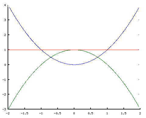

Consider the graph y = e^x
Make an equation that results in reflecting about the line y = 2
I came up with 2 - e^x
And when I put it in my calculator it makes sense.
Just -e^x is reflected among y = 0
so if you bring it up 2, to y = 2 then it will be reflected among y = 2.
My webassign says I am incorrect and its actually 4 - e^x, why is this? I don't understand the logic

Let [itex]f(x)=e^x[/itex] and g(x) denote the function we're looking for. When we reflect about the line y=2, what we're saying is that we want [tex]2-f(x)=g(x)-2[/tex] to be true for all values of x that are in the domain of f(x). So when f(x) = 2, g(x) = 2. Your equation [itex]g(x)=2-e^x[/itex] is actually a reflection of f(x) in the line y=1.

Say you have the function f(x)=0 (the x-axis) and you want to reflect this function in the line y=2. Would your answer be g(x)=2? No, because g(x)=2 is on the line of reflection. You want g(x) to be the same distance above y=2 as f(x) is below y=2. So you're looking for g(x)=4.
Look back the distance equation I gave you:
Does this make intuitive sense to you?
If we rearrange the equation to solve for g(x), we get
[tex]g(x)=4-f(x)[/tex]
That looks familiar, right? :smile:
Yes, [itex]-e^x[/itex] is a reflection in the x-axis, and yes, [itex]2+(-e^x)=2-e^x[/itex] will shift the function up 2 units, but this doesn't mean it's a reflection in the line y=2. Draw it out and understand that you want a function that reproduces f(x) below y=2 to another function g(x) above y=2. And vice versa, if f(x) is above y=2, then g(x) is below.

Hmmm - you missed off a step all right.
You forgot to translate back.
Probably best if I just show you with your own example.
Say you - to reflect ##f(x)=x^2## about ##y=1##, would give you ##g(x)=1-x^2##
Here it is:
... the blue curve is y=x2
... the red line is y=1: the mirror line
... the green line is y=1-x2
Notice how the green line is NOT the blue line reflected about the red one?
Easy test: put a small mirror on the red line and check.
Can you see what the correct reflected function is now?

A simple algebraic test that would catch the above mistakes: consider - if the graph crosses the mirror line, then the reflection will also cross the mirror line in the same places.
