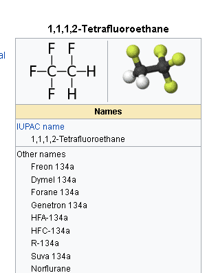

and a Freon 134 molecule https://en.wikipedia.org/wiki/1,1,1,2-Tetrafluoroethane

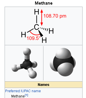

It all starts with a methane molecule
Carbon can bond with four other atoms at once. Methane, yes swamp gas, is a simple molecule and a building block for Mother Nature.
It's a carbon with four hydrogens attached.
https://en.wikipedia.org/wiki/Methane
If you replace two of methane's hydrogens with chlorine and the other two with flourine
you get the awful sounding chemical di-chloro-di-flouro-methane, the long anti-abbreviation for for a methane with two chlorines and two flourines instead of four hydrogens.
https://en.wikipedia.org/wiki/Dichlorodifluoromethane
whose short name is R12.

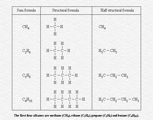

Now Ethane is just two methanes stuck together.
https://en.wikipedia.org/wiki/Ethane
The family goes on, Propane is three of them and Butane is four of them, Pentane is five and so on.
http://www.3rd1000.com/chem301/chem301j.htm
R134 is Ethane with four Flourines.
hence its scary name tetra-flouro-ethane
