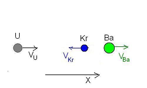

A uranium atom (U), traveling with a velocity of 5.00 x 10^5 m/s relative to the containing tube breaks up into krypton (Kr) and barium (Ba). The krypton atom is ejected directly backwards at a velocity of 2.35 x 10^6 m/s relative to the barium after separation. With what velocity does the barium atom move forward relative to the tube? You may assume no other particles are produced, and that relativistic corrections are small.
What is the velocity of the krypton atom relative to the containing tube? (Kr = 95.0; Ba = 140; U = 235 u)
Conservation of linear momentum.
The relative velocity factor is really confusing me on this question. I'm not sure how to incorporate this into general conservation of linear momentum equations. The answer should be 1.46 x 10^6 m/s but I got 2.43 x 10^6 m/s. I have tried a number of different approaches but can't get to the correct answer. Can anyone point me in the right direction please?
Thanks a lot
Sorry, it is the first part "With what velocity does the barium atom move forward relative to the tube?" which I am trying to solve.

https://www.physicsforums.com/attachment.php?attachmentid=63688&d=1383719144
See Figure. It shows the velocities with respect to the tube .
Relative velocity of Kr with respect to Ba is V(rel) = VKr-VBa. As the Kr atom is ejected backwards from the Uranium, and the Ba is ejected forward, the velocity of the Kr is less than that of the Ba, so its relative velocity is negative.
V(rel) = VKr-VBa= -2.35 x 10^6 m/s. That means
VKr=VBa -2.35 x 10^6 .
Write up the equation for conservation of momentum and solve for VBa.

EDIT 3: ehild, your figure doesn't show up for me.
I tried to apply the method to copy the PF URL of the picture into my post
Do you see the picture in the text now?
I used the laboratory frame of reference, velocities with respect to the tube. Anyway, the velocity of Kr with respect to the Ba is the same in both frames of reference: ##\vec V_{rel} =\vec V_{Kr}-\vec V_{Ba}##

Here is how I solved the problem using ehild's method. I'm afraid I'm not familiar with how to use the correct notation on this so I have presented it in the clumsy format below:
235 x (5 x 10^5) = 95(vba - (2.35 x 10^6)) + 140vba
1.175 x 10^8 = 95vba - (2.23 x 10^8) + 140vba
3.41 x 10^8 = 235vba
vba = 1.45 x 10^6 m/s

It is correct.
Man1la said:
I didn't mean to criticize your explanation at all Cepheid. Sorry if it came across that way. I'm really grateful for such a thorough explanation. You did include two equations to use, quite clearly. I have worked on it again and have almost got it, although I'm not sure of the significance of the first bold equation you gave, and I seem to have negative value where I should have a positive. I'll work out where I went wrong eventually I'm sure!
95vkr = -140vba
-(1.175 x 10^8) - 235vba = 95(vkr - vba)
-1.175 x 10^8 - 235vba = -2.23 x 10^8
I do not understand your equation. VBa and Vkr are opposite in that system, so Vkr is negative.
Better to use an other letter in this frame of reference, say U.
So
95 Ukr = -140 Uba and Ukr-Uba=-235 x106
"Galilean transformation" means that you add velocities as vectors. If you walk forward in a train with 2m/s and the train travels with 28 m/s, your velocity is 28+2=30 m/s with respect to the ground. When you walk backwards in the train, your velocity is 28-2=26 m/s with respect to the ground.
When the Uranium atom splits into two, the centre of mass of the particles moves with the original velocity of the Uranium. In principle, you use a centre-of mass frame of reference when working velocities with respect to the Uranium. In the CoM frame, the net momentum is zero.
When you have the velocities in the CoM frame of reference, just add the velocity of the CoM to get the velocities in the rest frame of reference.
If you solved the equations for UBa, adding the original velocity of Uranium (5.00 x 10^5 m/s) gives the answer.
