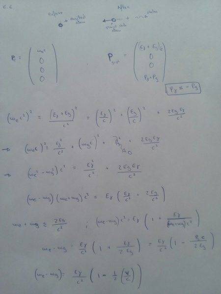

A stationary excited nucleus decays to its grpund state by emitting a γ-ray photon of energy Eγ. The grpund state nucleus recoils in the opposite direction at speed v. Show that when v<<c the change of mass of the nucleus is approximately:
me - mg = Eγ/c2 [1+ 1/2(v/c)]
v/c=pc/E
PμPμ = constant = (mc2)2
E2 = (mc2)2 + (pc)2
Pγc = Eγ
I used both, the cuadrimomentum conservation and the energy conservation. I think the solution should be directly found from the cuadrimomentum conservation, but I can not solve it.
Conservation of 4-momentum implies conservation of both relativistic energy and relativistic 3-momentum.
I'm not following what you mean here. It would be helpful if you showed some detail of your attempt to solve it this way.

Your work looks good, except I don't understand why you suddenly put in a negative sign at the very end. ##\frac{E_{\gamma}}{E_g}## is positive. ##E_{\gamma} = |p_{\gamma}|c##.
So, ##1 + \frac{E_{\gamma}}{2 E_g} = 1+ \frac{v}{2c}##.
I did that because I considered there Pg = - Pγ. But I think I am realising that this is only for the vectorial form, Isn´t it?
Yes.
