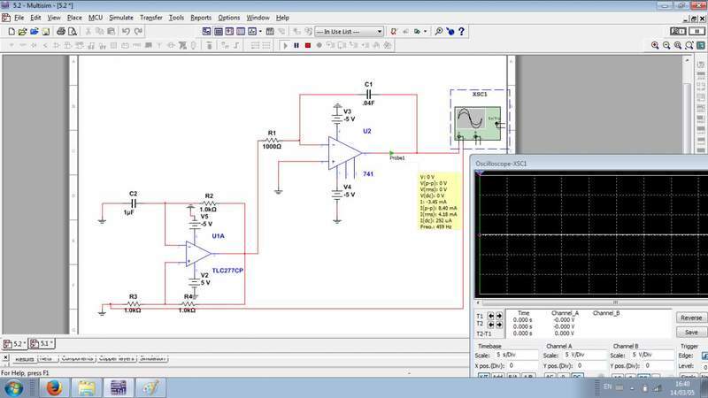

I have figured out that part about the relaxation oscillator, and my multisim now works. I am on the part about the triangle wave generator (page 7). I have derived the relationship, and now I am stuck making my triangle wave output.
I just took the circuit from the previous slide as my square wave and attached it to the triangle generator, and the oscillator just won't read a triangle.
The question asks to pick values of R and C such that the triangle waveform will have an amplitude of 4 V. I am a bit confused about this part I believe.
I just said that the y-axis is 4, and since f=10, then the time, or x-axis, is 0.1. That means RC = 40. So C = 40/R. Choose R=1000, then C = .04 F.
The supply is 5 V from my relaxation oscillator, so my square wave should be +/- 5V, but the oscilloscope for my triangle generator gives me nothing.
