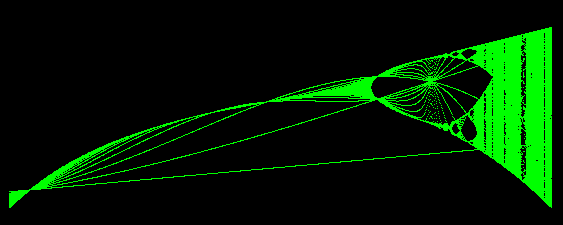

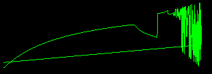

    Hello. I am attempting to render the bifurcation diagram of the logistic difference equation in C with OpenGL. I think the math behind it is simple enough, but for some reason I am ending up with a structure that resembles the tree but doesn't look quite like it. I would really appreciate it if someone could point out where I am going wrong. Here is how it should look like:
    http://brain.cc.kogakuin.ac.jp/~kanamaru/Chaos/e/BifArea/
    http://planetmath.org/encyclopedia/FeigenbaumFractal.html
    The following program produces the output attached to this post. As you can see, you can distinguish that the structure seems to be correct.

    I think you are only displaying the data point for the last iteration.
    Print out say the last few iteration values in the datapoint array, in each call to calculateplot(). When k is below 3, you will find they are all the same. Then, they start to flip between 2 diffeent values. Then they go round a cycle of 4 different values, then 8, etc. Later on, they are chaotic. Later still they will repeat in cycles with other lengths, like 6 and 3.
    You need to plot all the different values to make the complete graphic. One way is to calculate say 1000 iterations, to wash out the effect of your choice of a starting value, and then plot say the next 100 iterations. Many of the 100 plotted points will lie on top of each other, but that doesn't matter.

    Hello. Thank you for the reply.
    Take a look at this:
    Code (Text):
    double dataPoints[NUM_OF_SETS][(int)NUM_OF_ITT][2];
    This multidimensional array contains the x-y coordinate data for each k that is going to be tested. The number of different k's tested will be NUM_OF_SETS k's. The difference of some k and the next k tested will be 3/NUM_OF_ITT. Here's the routine that precomputes the data for better rendering times. I think the problem may lie here:
    Code (Text):
    void calculatePlot(double k, unsigned int inx)
        double result = k*xstart*(1.0-xstart);
        dataPoints[inx][0][0]=k;
        dataPoints[inx][0][1]=result;
        for ( unsigned int i = 1; i < NUM_OF_ITT; i++ )
            result = k * result*(1.0-result);
            dataPoints[inx][i][0]=k;
            dataPoints[inx][i][1]=result;
    0 <= inx < NUM_OF_SETS. Note how the x coordinate is always set to the k being tested. I am not sure whether this is the right way of doing it. Some implementations plot (g(x), x) where g(x) = X(n+1) = k*Xn*(Xn-1). Others simply have the k being tested as the x value. Other still use (x, g(x)).
    This is the rendering procedure, which is relatively simple. Note, right now for each k being tested the x value for each point is k itself, and only y varies. And so you would expect to see a vertical line for each k, with the points between dataPoints[set][0] and dataPoints[set][NUM_OF_ITT-1] being transient states. Therefore those points are not rendered here. However, that data is still available and can be rendered. Indeed originally it was rendered, but I saw only vertical columns connecting the top outline and the bottom outline. So I simply decided to omit those points from rendering.
    The mechanism of rendering is simple: We loop through all the sets (the data for all the k's tested) and render a line strip using the first point calculated. Then the same procedure is repeated, rendering the last data point in the array for each set.
    Code (Text):
    // not rendering the transient states
    glBegin(GL_LINE_STRIP);
    for ( unsigned int set = 0; set < NUM_OF_SETS; set++ )
        glVertex2f(dataPoints[set][0][0], dataPoints[set][0][1]);
    glEnd();
        glVertex2f(dataPoints[set][(int)NUM_OF_ITT-1][0], dataPoints[set][(int)NUM_OF_ITT-][1]);
    glEnd();
    I don't know what I am doing wrong. I am sorry, but I really have no background education of dynamic systems (being a high school senior). I just love math/realtime computer graphics. Further help would be much appreciated.

  8. Mar 13, 2011 #7
    I am sorry :( I know it can be a nightmare trying to interpreted undocumented code, so I will try to explain to the best of my abilities what I am doing in the code:

  9. Mar 13, 2011 #8
    I am the biggest idiot in the world. As opposed to drawing lines, I should have simply drawn points. The structure seemed correct because it was. There was simply extra information there. I hope I am making sense. Thanks for the help all. Attached picture + the working source below.
    Code (Text):

  10. Mar 13, 2011 #9
    AlephZero
    User Avatar
    Homework Helper
    Well, it's not quite right yet, because you have those strange lines from the bottom left hand corner.
    They are the points when you "start up" the iteration from x = 0.1, until it settles down.
    If you change 0.1 to a differrent value (say 0.9) you will get a different pattern of those lines.
    To get rid of them completely, change the line in drawscene() from
    for ( unsigned int i = 0; i < NUM_OF_ITT; i++ )
    to something like
    for ( unsigned int i = NUM_OF_ITT/2; i < NUM_OF_ITT; i++ )
    to skip over the first points you calculate.
