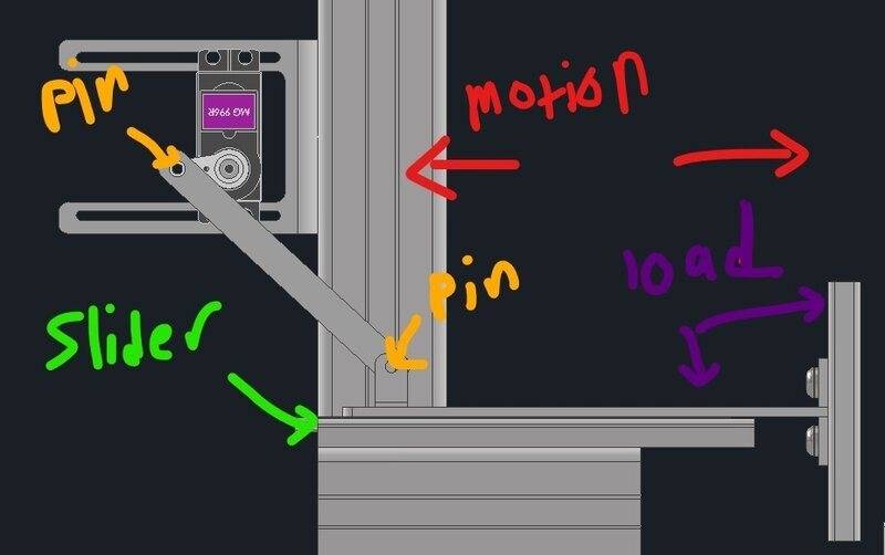

Required torque calculation

TL;DR Summary
how to calculate the required torque for the mini servo to move the load on slider?

What you have is a highly offset slider-crank mechanism.
Are you concerned with simply holding the slider against a load, or do you want to accelerate the slider? If you want to accelerate the slider, then at what rate? You need to give us a bit more to work with.
I am confused.
How many separate parts are there ?
What can move relative to what ?
What bits are the fixed frame or chassis ?
I want to move the load (it is actually a heater) that was mounted on the slider at 0.5m/s either to the left or right.
A constant velocity on the velocity will require a variable crank speed. Are you prepared to control crank speed to vary in a specific way?
I hope you are aware that the slider moves only over a limited range. As you approach the ends of the range, the velocity must approach zero in order to reverse. Is this satisfactory for your purposes?
