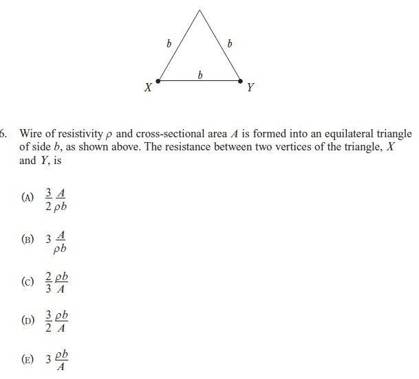

R=pL/A
The answer is C and I don't know why. If R = pL/A then isn't L=b between X and Y?
There are 2 wires running from X to Y. These wires are in parallel. One is of length 2b, and the other is of length b. You need to find the overall resistance of these two resistors in parallel.
I don't think that this problem is stated very well. I think it should state outright that there are two resistances in parallel.
that makes sense. thank you
