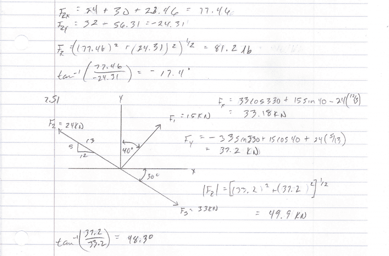

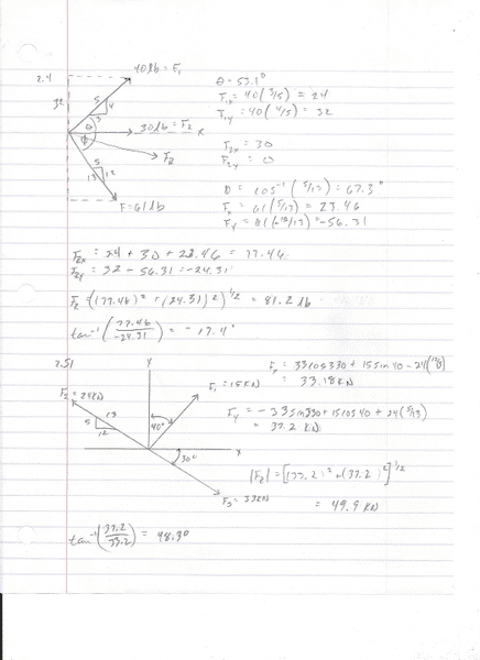

Determine the magnitude of the resultant forces and direction of the resultant as measured clockwise from the positive x axis.
Please help. I have entered my answers into masteringengineering.com and it keeps telling me my answers are wrong. Not sure why?

Your setup for Fnet, x looks right, but I get a different numerical result for Fnet, x.
For F3y you have -33 sin (330). Should you include the negative sign in front of 33?
Good point with the negative sign! I got the answer now. Muchas gracias muchachos!
