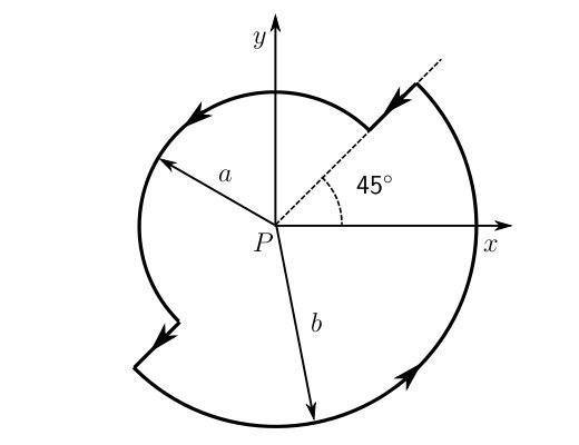

there's a wire shaped as a circular loop that carries a current I=ct. half the loop has radius A and at 45 degrees the radius of the second half of the loop changes to b. Find the retarded potentials V(t) and A(t)
The way i thought of approaching this is by dividing the loop into two sections and calculating the retarded potentials separately for each half of the circle. So, I would have two integrals of the form dl, and each integral would have the limits of integration associated with each part of the loop my only concern is that is one single wire, so I don't know if my initial approach would be correct.

Your problem description isn't 100% clear to me...could you provide a sketch of the wire loop? (Also, in the future, please use the homework help template...when you signed up for your account, this was one of the forum rules you agreed to!:wink:)
Anyways, your approach seems fine to me...why would treating each section of the loop separately cause any problems?
What do you get when you apply this approach?
thanks for the reply gabba. I uploaded a picture, and I thought I did use the template provided. maybe part c was the one I didnt do.
I haven't plugged anything in, but I was thinking using V1-V2 = int(dl) - int(dl), however, since I only have half of the circle, should my limits of integrate for d(phi) be from 0 to pi and not 2pi?
my problem with doing this is that I've only seen this approach when having two radii for let's say to spherical shells close to each other.

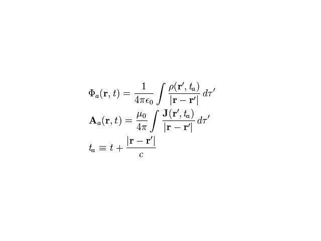

I don't know how to enter formulas so I'm posting an image of the formulas. so, I pretty much need to find phi and A, for the configuration in the previous picture of the wire carrying a uniform current I=ct

Those are the formulas for the advanced potentials... the retarded potentials are given by:
[tex]\Phi_r(\textbf{r},t)=\frac{1}{4\pi\epsilon_0}\int \frac{\rho(\textbf{r}',t_r)}{|\textbf{r}-\textbf{r}'|}d\tau'[/tex]
[tex]\textbf{A}_r(\textbf{r},t)=\frac{\mu_0}{4\pi}\int \frac{\textbf{J}(\textbf{r}',t_r)}{|\textbf{r}-\textbf{r}'|}d\tau'[/tex]
[tex]t_r\equiv t-\frac{|\textbf{r}-\textbf{r}'|}{c}[/tex]

Anyways, you have 4 sections of current carrying wire (two straight and two curved)...Let's start with the curved section of radius [itex]b[/itex]..which direction (you may as well use cylindrical coordinates [itex]\{s,\phi,z\}[/itex]) does the current flow in that section?
If you have griffith, look at problem 10.10, page 427, sec. 10.2...it doesn't seem like we have to actually have to worry about the straight pieces. and if we use cylindrycal, then I moves in the phi direction.
You always have to consider every piece of current and charge...it just so happens that due to symmetry, the contributions to the vector potential of the two straight pieces cancel each other out at the center in that problem...things need not be the same for your problem.
Anyways, yes the current in the curved section moves in the [tex]\hat{\mathbf{\phi}}[/itex] direction. Now, given that the current density is defined as
[tex]\textbf{J}\equiv \frac{d\textbf{I}}{da_{\perp}}[/tex] (equation 5.25)
It should be clear that it will be zero everywhere except along the wire; and since the wire has zero extend perpendicular to itself, [itex]\textbf{J}[/itex] must be infinite along the wire. Yet, it must produce a finite result [tex]I(t)\hat{\mathbf{\phi}}[/tex] when integrated over the directions perpendicular to the wire...hence the need for Dirac delta functions.
So looking at the same curved section of wire, you see that it has zero extent (width) in both the radial and axial direction and hence you should expect to see a current density of the form
[tex]\textbf{J}\propto I\delta(s-b)\delta(z)\hat{\mathbf{\phi}}[/tex]
for [itex]-\frac{\pi}{4}\leq\phi\leq \frac{\pi}{4}[/itex] and zero elsewhere (due to just the curved section of radius [itex]b[/itex])
Right?
Now use equation 5.28 to find the proportionality constant and then use a similar method to find [itex]\textbf{J}[/itex] due to each of the other 3 sections.
