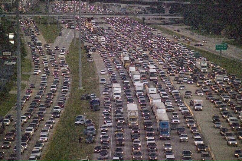

The Miami Herald posted this story. Built for bottleneck: Is Florida growing too fast to evacuate ...
The article made a good point that I hadn't considered. A good evacuation plan does not require 10 million people to drive 600-1000 miles away. It means driving 10-20 miles inland to a shelter. In south Florida, 10-20 miles inland puts you in the Everglades or Big Cypress Swamp. Those are really bad places to build 10000 shelter buildings, holding 1000 people each.
But then I thought of I75. It is an elevated roadway that crosses south Florida east-west. Suppose we told people to drive onto I75 and park on the highway. Just that one highway could park 250000 passenger cars (200 miles * 6 lanes * 5280 / 25 feet per car). Alligator Alley and the Florida Turnpike Could also be used.
Perhaps Quonset-hut-like shelters could deploy to shelter the parked cars and to provide services. Maybe not. I'm short on details other than the following two thoughts.
  1. A good plan would make use of our highways and private vehicles as resources to help provide the shelter, rather than being part of the problems to overcome.
  2. The engineering challenges to make such a plan practical and affordable would be enormous. I suspect that many of my fellow engineers would relish being assigned to the project to think such a plan through, complete the design, then implement it.
This would basically mean to build a 100 mile long tunnel with many junctions for its regular use, which must be wind shielded somehow. With it we would buy the severe danger of fires in the tunnel, which means separated escape tunnels would be needed and a complicated system of smoke handling. Again additional openings would follow, which are especially vulnerable to hurricanes: smoke out means hurricane in. And then there is the math. Let us assume four lanes on 150 km length with 5 m long cars, four persons in each car. That is roughly half a million people, and only if all behave according to the plans. I suspect that the chaos in case of an evacuation will be even higher than the one the tunnel is expected to avoid. And we would need a system to get rid of all the exhausts, which again results in additional openings. And then there is still the problem with the rising sea levels ...

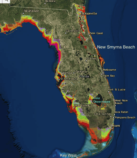

It's wrong to take a too narrow view of natural disasters. It is not just buildings and wind damage. For example, if too many people remain in flooded areas, dysentery, cholera, and typhoid can be the biggest killers in the long term. Public officials are forced to consider things like that when making evacuation decisions.
It is also hard to make a general rule about the evacuation area. The flooding from Hurricane Harvey extended 150 miles (250 km) from the sea. Hurricane Irene's severe impacts extended more than 300 miles (500 km) from the sea.

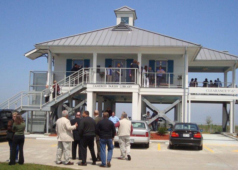

I may be missing something here, but how about developing buildings to be hurricane proof and put that in the building codes?
Then evacuation can consist of going to the nearest hurricane proof building if your own building is not hurricane proof yet.

I suspect a lot of this comes down to cost. A hurricane-proof house is more expensive than one that isn't. And despite the damage inflicted by the recent events, the relative probability of any given house being destroyed by a hurricane is probably still very small. So for the average homeowner or home builder, the added cost of "hurricane proofing" a house may not be worth the risk.
And remember, you can have a hurricane proof house, but you also need hurricane proof infrastructure too. Your fine house may not seem all the great with the water cut off, or no electricity, etc. Burying those cables costs money. In the next election, one guy will run on a platform that raises taxes to pay for the extra cost. How viable will that platform be if people aren't immediately worried about hurricanes during the election?
