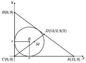

If you mean angle bisectors, then Wikipedia says the radius of the inscribed circle is $r=(a+b-c)/2$ where $a$ and $b$ are legs and $c$ is the hypotenuse. Thus, if we arrange the triangle so that its right angle is in the origin and legs go along the $x$ and $y$ axes, respectively, then the coordinates if the inscribed circle center (which is also the intersection point of angle bisectors) will be $(r,r)$. The hypotenuse ends will have coordinates $(12,0)$ and $(0,9)$, so it is possible to find the middle $D$ of that segment. The intersection point of medians lies $2/3$ of the way from $(0,0)$ to $D$. This way you can find the coordinates of the intersection of medians. Then find the distance according to the usual formula for two points with known coordinates.

could you solve my problem please i don`t understand the drawing
Here is a picture that uses notations from post #7.
https://www.physicsforums.com/attachments/3563._xfImport
