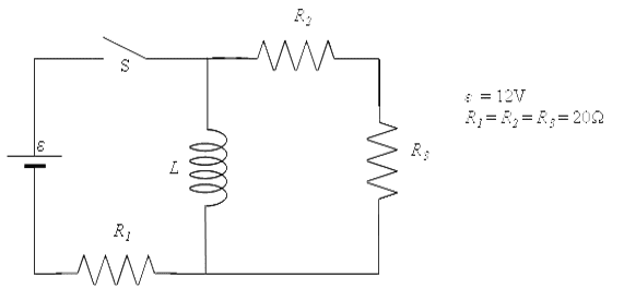

A circuit made with a battery, a switch, an inductor. and three resistors is shown in the figure. To begin with, switch S has been open for a long time. Then at time t = 0 the switch is closed.
http://i.imgur.com/ws5UD.png
After being closed for a long time, the switch S is now opened.
What is the direction of the current in the right hand loop containing L, R2 and R3 immediately after the switch is opened?
(a) clockwise
(b) counterclockwise Correct Answer
Ampere's law?
I am not sure how do I ind the direction of current if switch is opened? Should be no current?
Thx
Before the switch is opened, what currents are flowing and in what directions?
There are current on r2,r3 and inductor and it is clockwise...
No, that's not right. Yes, there is current through the inductor, but what is that current and what is the voltage across the inductor? What about R1?

When the switch is first closed, the current will flow in a counterclockwise direction in the right hand loop containing L, R2, and R3. This is because the inductor resists changes in current, so it initially acts as a barrier to the flow of current.
When the switch is opened, the flow of current is disrupted and the inductor will try to maintain the current flow. This means that the current will continue to flow in the same direction, counterclockwise, in the right hand loop.
Therefore, the correct answer is (b) counterclockwise. This can also be confirmed using Ampere's law, which states that the direction of the magnetic field created by the current is always perpendicular to the direction of the current flow. So if the current is flowing counterclockwise, the magnetic field will be directed out of the page, as shown in the figure.
