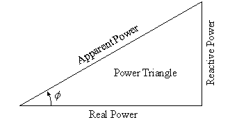

Effectively, the wattmeter shows you the Real (or average) value of the power delivered, which is the power actually consumed by dissipative devices (resistors in this case).
On the other hand, multiplying the voltage and current meter readings yields the Apparent Power delivered, which is the magnitude of the complex power including the Real and Imaginary (reactive) components. The Real power is dissipated on resistances while the imaginary power is stored and returned by reactive components.

Think of a heater: connected it to AC supply, it warms up, produces heat. The voltage is in phase with the current in case of a resistor, so the instantaneous power is P=UI=Umax(coswt)Imaxcos(wt). The temperature of the resistor will not change together with the instantaneous power, but depends on the average power. The average power on a resistor is Pav=UrmsIrms= Umax*Imax/2.
When the voltage and current are not in phase but there is a φ phase difference between them, the average power is UrmsIrmscos(φ)
