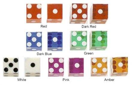

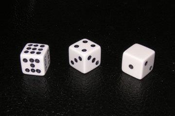

If it's a pitted die, as depicted, it is imperfect with respect to fairness by virtue of non-uniform density.
These flush-faced casino dice are closer to fair:

Indeed. And worse than normal dice because of the large discrepancy in number of holes.
Also, I did not distribute the numbers around the faces. You'll notice that 7 and 9 are adjacent.
My plan is to fill the pits with epoxy, then retest to see if that fairs them up.(Also: Dude wth! My post is all centre-jusitifed cause-uh you! )​

I would be surprised if the difference shows up before millions of tosses. I think that the tiny difference would be lost in other random influences.

Well, that's why we do empirical observations. To surprise us (or more accurately, to disabuse us of our preconceptions).
