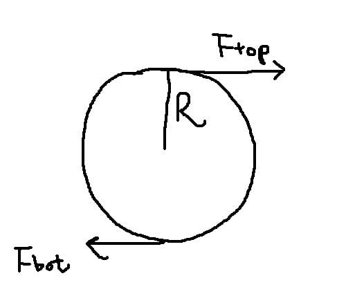

A plank with a mass M = 6.00 kg rides on top of two identical solid cylindrical rollers that have R = 5.00 cm and m = 2.00 kg. The plank is pulled by a constant horizontal force F of magnitude 6.00 N applied to the end of the plank and perpendicular to the axes of the cylinders (which are parallel). The cylinders roll without slipping on a flat surface. There is also no slipping between the cylinders and the plank. Find the acceleration of both the plank and rollers.
Answer is 0.8 ms-2 for the plank and 0.4 ms-2 for the cylinders.
I can solve the problem cause I asked some other guys... but I don't really understand the method. It goes something like this:
Draw a freebody diagram of the roller, such that there are two frictional forces. So that means there is a resultant torque, which we can equate to N's second law in angular form. --- 1 eq, and two variables.
Note: supposing the system is accelerating to the right; the direction of the friction at the rollers both point towards the RIGHT. That's one point where I'm stuck. My rationale for this is as follows: relative to the plank, motion of the roller is towards the left, and since friction acts in direction opposite to motion, friction at the top of the wheel therefore points towards the right. Now, this frictional force produces an ACW torque, so at the bottom of the wheel, there is another frictional force acting towards the right. That makes sense? I dunno. I tend to make these things up just so I'm happy with everything. Need clarification.
And then, the second equation shows the relationship between the roller's and plank's acceleration. I understand this part, but I'm just going to put it on, so people can work through it. The acceleration of plank is double that of the rollers- ---- 2nd equation - one new variable.
Then we have the planks moving relative to the cylinders, with 2F acting against it... F is friction. SO that's another equation with 2 variables... no new variables.
Then finally (this is where I get stuck)... we apply N's second law (linear form) to the rollers, with the friction at the top and bottom, equating to ma_rollers. I'm wondering why we can use this equation; would that not imply that the rollers was sort of slipping along the ground, and not rolling. I don't know if I'm making sense. But it doesn't matter really. I just need someone to help give some sort of rationale to the use of this equation. Any help would be appreciated.
ANyway, so we have four equations, with four variables. Solve simultaneously to get the result.
The plank is pulled to the right then friction on the plank will be in (opposit) left direction. according to the N's third law the reactionary friction on the top of the roller is towards right.
Now with this force F (on each cylinder) find torque and angular acceleration about instatenious axis of rotation, from the contact point at bottum. This gives acceleration of center of mass of the cylinder equal to 4F/3m which is greater then F/m hence the friction at bottum must be F/3 in forward direction.
The friction on the top and the bottom of a cylinder are not equal. This pair of force constitute a couple (torque) and a force. With the net force you are finding the acceleration of center of mass of the cylinder(translational) and with the net torque you are finding the angular acceleration of the cylinder about it axis(passing through center of mass)(rotational). The combined motion is given by only rotation about the bottom( instantaneous axis of rotation)

Hi,
Sorry to dig this thread up, but I've encountered the exact some problem and I'm trying to understand arildno's solution.
In equation (B), he mentions that
[tex]
rF_{top}-rF_{ground}=I\frac{d\omega}{dt} (B)
[/tex]
However, by drawing the free body diagram for the roller, shouldn't the equation instead be
[tex]
rF_{top}+rF_{ground}=I\frac{d\omega}{dt} (B)
[/tex]?

Now coming to the problem at hand,lets say that the plank is moving right. Now let's focus our attention on the right roller , at the point of contact between the plank and the roller.
If the roller doesn't move, then the plank will start sliding to the right. Now if the roller doesn't move then the roller is sliding to the left RELATIVE TO THE plank. Kinetic friction exerted by the plank on the roller will oppose this and the direction of the kinetic friction will be the the right. Now this process happens for a fraction of a second. As a result, the roller starts rolling. So once roller starts rolling, kinetic friction drops to zero,since there is no longer a relative motion between the roller and the plank. (Remember that in pure rolling motion, the point of contact between the rolling body and the ground is always at rest relative to the ground). But there is a force F applied to the right on the plank. So to prevent the sliding between the roller and the plank, there will exist a friction force on the roller to the right. Now this is no longer a kinetic friction but the static friction since the point of contact between the roller and the plank is at rest relative to the plank.
Ok we got the direction of the static friction on the roller at the top, which is rightwards. Now let's think what happens between the roller and the ground. Now the force which at the top of the roller is at right. This force is not passing through the center of mass, so it will cause a torque around the axis passing through the COM. So this torque will cause the roller to rotate clockwise. If the roller rotates in clockwise direction, then there will be sliding at the point of contact between the roller and the ground. So ground will exert a force in the opposite direction (forward direction) to oppose the relative motion between the roller and the ground. This force exerted by the ground is the static frictional force ,since , during the rolling, the point of contact between the roller and the ground is at rest relative to the ground.
So we established two static frictional forces which act on the roller. One at the top and one at the bottom. And they are both directed rightward. These static frictional forces maintain the rolling motion by preventing the sliding. The whole role of the static frictional forces here is to prevent the sliding (or in other language, relative motion between the surfaces).
Now let's say that the force at the top is f1 and the one at the bottom is f2. In vector form,

[tex]\vec{\tau_{net}}=(f_2 R)(\hat{k})+(f_1 R)(-\hat{k}) =I\vec{\alpha}[/tex]
