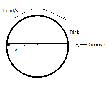

We have a disk of mass M and radius R placed on a horizontal plane. A cylindrical groove of radius r is made on a diameter.Now a sphere of mass m and radius r is placed in the groove at the circumference of the disk.
At t=0 the whole system is rotated with an angular velocity 1rad/s as shown in the figure.Also at the same time the sphere was projected with a velocity v towards the center of the disk.Find the minimum velocity of the sphere such that it is able to reach the other end of the groove.

The disk is fixed about it's centre that is it can only rotate
I think if the ball crosses the center of the disk the centrifugal force will be enough to move that ball to the other side of the groove.
I think the minimum velocity in this case is the velocity which is enough to move the ball to the center of the disk.
Here the angular velocity of ball keeps changing, I think.
At distance x from the center of the disk let the angular velocity be ω_x.
I[itex]_{i}[/itex] ω[itex]_{i}[/itex]=I[itex]_{x}[/itex]ω[itex]_{x}[/itex]
ω[itex]_{x}[/itex]=MR2+2mR2)/(MR2+2mx2)
ω[itex]_{x}[/itex]=16/4+3x2
I think the total energy of the ball will be entirely converted to the potential energy.

I think the total energy of the ball(rotational+kinetic) will be entirely converted to the potential energy.
Potential energy=[itex]\int mω2xdx[/itex]
Limits are from R to 0
=256m[itex]\int xdx/16+9x4[/itex]
Substituting x2/t=2 and xdx=dt
256m[itex]\int \frac{dt}{4(4+t2)}[/itex]
=[itex]\frac{256m}{4}[/itex][itex]\frac{1}{2}[/itex]tan[itex]^{-1}[/itex][itex]\frac{t}{2}
[/itex]
=256mπ/32
=1/2 mV2+1/2 Iω2 =256mπ/32
=1/2 mV2+1/2 mR2/2 =256mπ/32
on solving we get
V2=16π-4
V=6.80

Where are the parentheses? Because you wrote ω=4+3x2. Do you think it is right?
What frame of reference you use? If it is a rotating frame, the angular velocity is zero and so is the rotational energy. If it is a rest frame of reference, there is no potential energy.
And comb up your formulae. Tex does not understand
ehild

I have some doubts regarding the problem formulation, the answers to which may either make the problem relatively simple or significantly complicate life.
First of all, is there an external constraint keeping the disk rotating at the same angular velocity? If not its angular velocity is going to change with time, making it more difficult to go to a frame rotating with constant angular velocity.
Second, is the ball rolling or sliding through the groove? If it is rolling without slipping you will also have to take that kinetic energy into account.
Since the mass of the disk is given, I think it is safe to say this is an isolated system.
Rolling without slipping would be extremely tough to handle. Since the ball exactly fits the groove, you'd have to take it as slipping, frictionlessly, everywhere except where the normal force acts. That point will change, resulting in complex gyrations of the ball. So I'm pretty certain it should be treated as a frictionless particle.
Ep=[itex]\int mω2xdx[/itex]
ω2=256/(4+3x)2
On putting values I got
Ep=-[itex]\int \frac{xdx}{(4+3x^{2})^{2}}[/itex]
Putting (4+3x)2=a So da=6xdx.
Substituting the values
Ep=-[itex]\frac{256m}{6}[/itex][itex]\int \frac{da}{(a)^{2}}[/itex]
On putting m=3 and after simplifying
=128-[itex]\frac{1}{a}[/itex]
Putting a=(4+3x)2
=-[itex]\left (128-\frac{1}{(4-3x^{2})}\right)[/itex][itex]^{0}_{2}[/itex]
Om putting the values I got it 24
As 1/2 Mv2=E[itex]_{p}[/itex]
So 3/2 V2=24
So V=√16
=4 m/s.
Got correct answer.
I did it by choosing rotating frame of reference.
ehild
Could you please explain why there is no potential energy in a rest frame of reference?
I searched for it in senior secondary school physics book but didn't find.
I used rotating frame of reference and I got correct answer.

Yes, that all looks good, and quite neat.
The rest frame of reference is fixed to the outside world. To the table, for example. The only potential energy could be that of the gravity. But it does not change as the whole motion is horizontal. In the rotating frame of reference, the centrifugal force has potential. You did it well, congratulation. But next time indicate what frame of reference you use.
I used the rest frame of reference and conservation of energy. Got the same result.

Sorry for the late response.
I have studied somewhere that centrifugal force is a pseudo force.
And I know that we have to take pseudo force in consideration if we are watching an object from an accelerating frame of reference.
Here I have used a rotating frame of reference which was moving with the rotating disc.
So, I have used an accelerating frame of reference hence I have to consider pseudo force( i.e. centrifugal force in his case) and work done by this force get stored in the form of potential energy.
If I observe the motion of the ball from a rest frame of reference(like from the Earth) then in that case in we don't need to consider pseudo force as it is an inertial frame.
So if we are watching ball from the Earth then which force is decelerating the ball.
As ball is also following a circular motion so there must be centripetal which is acting towards center so ball should accelerate while going towards the center.
I know that this is an odd confusion but could you please help?
There is no centripetal force in the inertial frame of reference to keep the ball on circular track, so it would move along a straight line if it was free. But the groove forces it to change direction. Using polar coordinate system, it has tangential component of acceleration. And the radial acceleration is outward without the centripetal force, which would force it to travel along a circle.
ehild
ehild
As 'v' velocity is initially given to ball so it it tends to move towards the center of disk due to inertia of motion. I think a reactionary force is acting on it by the walls of groove is responsible for tangential acceleration.
How do you found that the radial acceleration is outward?
I was not exact enough. The ball motion towards the centre slows down, it means "outward acceleration" but I meant ##\ddot r##. As the centripetal force is zero, the whole radial component of the acceleration ##\ddot r -r\omega^2=0##.ehild
You don't need to. It is enough with conservation of energy and angular momentum.
Likes 1 person
You can also follow Nathanael's hint. ##\ddot {r }=0.5 \frac{d(v^2)}{dr} =r \omega^2 ## . You denoted r by x, so ## \ddot x = 0.5\frac{dv^2}{dx} =x \omega^2 ## and ##\omega=\frac {16}{4+3x^2}## Integrate.
ehild
Initial energy of the system=[itex]\frac{mv^{2}}{2}[/itex]+[itex]\frac{I_{B} ω^{2}}{2}[/itex]+[itex]\frac{I_{D} ω^{2}}{2}[/itex]
Final energy of the system will be in the form of rotational energy of the disc.
So
EF=[itex]\frac{I ω^{2}_{f}}{2}[/itex]
By law of conservation of angular momentum
I[itex]_{i}[/itex]ωi=Ifωf
ωf=[itex]\frac{MR^{2} +2mR^{2}}{MR^{2}}[/itex]
ωf=4
On equating initial and final energies
[itex]\frac{3v^{2}}{2}+\frac{mR^{2}}{2}+\frac{MR^{2}}{4}[/itex]=[itex]\frac{16 MR^{2} }{4}[/itex]
[itex]\frac{3v^{2}}{2}+8[/itex]=32
So v=[itex]\sqrt{16}[/itex]=4m/s.
Got correct answer.Thanks Orodruin.It is very much easy to solve this question through with conservation of energy and angular momentum.
