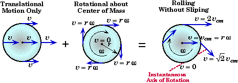

    A 30cm diameter wheel rolls without slipping at 120rpm. The point of contact with the ground has an instantaneous speed of:
    a-5.2mm/s
    b-1.04cm/s
    c-2.6 m/s
    d-zero
    2. Relevant equations
    I'm not really sure about my final answer but i think is d-zero because i have a diagram of a wheels that has 0m/s on the bottom of the wheel.
    3. The attempt at a solution
    If the correct answer is not zero i think i will need the following formula
    I=MR^2
    but i'm only given diameter and rpm's so i don't know if there's anohter formula i'm missing.

    Newton9, your first answer was corret. "Rolling withing slipping" means the point of contact has zero instantaneous velocity. The object would be slipping if the contact point had a non-zero velocity.

    If you look at the third diagram given in the first post you can see that the centre of the wheel has a constant speed v (translational velocity). the top of the wheel has a speed of 2v which is the tangent velocity of the point on the rim of the wheel and the translational velocity. Thus the point at the bottom of the wheel (the point of contact) has a tangental velocity that is opposite to the translational velocity and the two cancel.

    wow... that's kind of unintuitive. It almost seems as if you're in a frame with a velocity equal to the translational velocity of the wheel.

    There's a famous photo of a wheel with its centre as a green light and a point on the rim as a red light and it illustrates it beautifully but I'm having trouble finding it on the net. If I do find one i'll give you the link and perhaps it will shed more light on it for you.
    EDIT: this helps me anyway.
    http://img242.imageshack.us/img242/8971/rollingmotionoi9.th.jpg [Broken]
    Apologies for the crude photo but I gave up on the internet.
