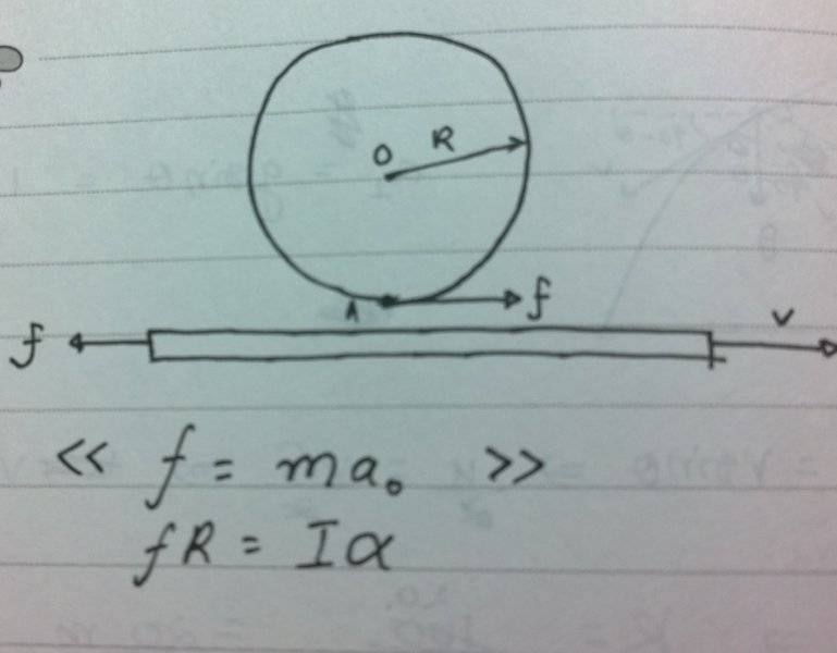

When you put o disc on top of a plank and if you pull the plank, the disc rotates but stays stationary.
Here the friction between the plank and disk produces an unbalanced torque and hence it spins.But this friction should also cause an acceleration in the disc right? Then why does it remain stationary?
who gived the assumption that it stay stationary? it does not stay stationary at all i think, just apply Newton's law...i'm curios about answers to this question :)
Sorry. It doesn't stay stationary. Actually i was thinking about this question. I did not understand it properly.
