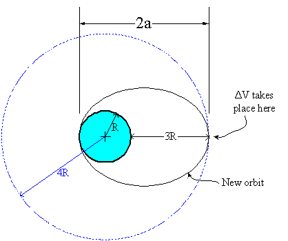

Hint: Investigate the specific energy of the new orbit assuming a gravitational parameter ##\mu_p## for the planet. How is it related to the semimajor axis of the orbit?

It also happens to be related to the size of the orbit's semimajor axis:
$$\xi = -\frac{\mu_p}{2a}$$
In your problem you can determine the semimajor axis for the "new" orbit quite easily if yuo make a sketch.

I'm not seeing where that comes from. You can just read "a" directly from a sketch of the obits.

gneill...Thank you very much for the sketch .I could not have visualized the situation , if you would not have made the picture .
Well...I guess I am having problem with the basics of gravitation. But you have been extremely nice .

From the sketch , a =5R/2
Now β2v2/2 - GM/4R = -GM/2a
β2GM/8R - GM/4R = -GM/5R
β2GM/8 - 1/4 = -1/5
Solving , I get β = √(2/5)
Hence k=5 .
Is it correct ? I don't have the answer key .
Edit: I have used β instead of μ(as originally given in the question) so as to avoid confusion with the use of μP i.e gravitational parameter .

The energy of an orbit specifies the size of its semimajor axis. Apogee and Perigee lie at either end of this axis. Since the elliptical orbit has been given a smaller energy than the original orbit, its semimajor axis is reduced in size. The semiminor axis of an ellipse is always smaller than the semimajor axis. Together this means that the elliptical orbit must lie within the bounds of the original circular orbit (its smaller and fits inside. See the image in post #11). As the orbits must touch at the point the change was made, this makes that point an extrememum of the smaller orbit. i.e. apogee.
Another way to look at it is that the new velocity of the object is insufficient to support circular motion at its then current position, so as it moves away from that location it must fall closer to the planet. By time symmetry (orbit has the same shape if time runs forwards or backwards) that make the current point the extremum which is the furthest point from the focus (apogee).

It looks good to me :smile:
