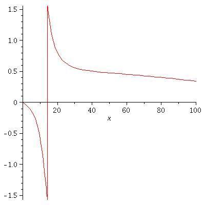

hi all,
I am facing a confusing problem with scattering theory and any hint would be greatly appreciated..
In the famous scattering by a square well problem the phase shift[tex]\delta[/tex] is a smooth curve in the particle energy... but what I get from my own derivation is not exactly as it should be (see attached file)...
any hint?
Your phase shift has jumped by pi, probably at the energy where a bound state appears.
The bound state pulls the wave function in, changing the phase by pi.
Thank you.. however the figure doesn't show the expected behaviour at small energies...
I attached a pdf file showing what I did exactly, hoping that somebody will discover what the problem is in my derivation..
I am really desperate to know..
  • scattering.pdf

I don't know what you mean by the above statements.
Your figure in the thumbnail looks like what I would expect.
I can't (won't) go through your steps in detail, but they seem like what I have seen in textbooks.
exactly, it seems like is given in textbooks.. but getting through it is another thing
