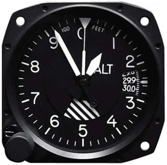

phinds said:
I don't know if human measurement devices exist that can tell the difference in air pressure over, say, 10 feet at 1G
There is, and it does:
The image is of an aircraft altimeter showing 920 feet altitude above mean sea level at a barometric pressure reading of 29.92 inches mercury. The skinny hand is 10,000 feet per numbered division, the short hand is 1000 feet per division (10,000 feet per revolution), and the large hand is 100 feet per division (1000 feet per revolution). The little tick marks are 20 feet apart.
You could also use an ordinary barometer. One thousand feet of altitude change is one inch of mercury pressure change, so 10 feet is 0.01 inch mercury. A good barometer should show that if you tap it lightly.
Or you can calculate the rate of change of pressure with altitude. It's the same rho*g*h calculation used for liquids. Rho for air is about 0.0765 lbs/cubic foot at standard temperature and pressure.
