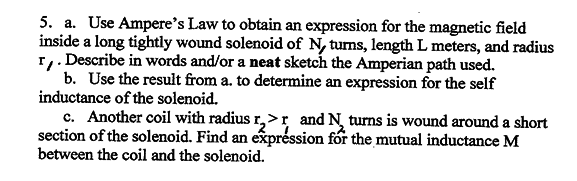

[/B]
∫BdL = μi
Φ = BA (flux)
S= NΦ/i (self inductance)
M = NΦ/i (mutual inductance)
a) ∫BdL = μi
BL = μi
B = μi/L
since the solenoid has N1 turns
B = μiN1/L
b) flux Φ = BA = AμiN1/L
self inductance S = N1Φ/i = N1(AμiN1/L)/i = N1^2μA/L
c) mutual inductance M = N2Φ/i = N1N2μA/L

If i is the current flowing in the wire of the coil, the formula ∫BdL = μi is not correct. You need to show or explain the integration path .

For part a), I would assume ##\vec B## is uniform within the solenoid and zero outside of it. If you place a rectangular Amperian loop ##\partial \Sigma## with corners ##a, b, c, d## along a cross section of this ideal solenoid, the left side of Ampere's law will give:
$$\oint_{\partial \Sigma} \vec B \cdot d \vec S = \int_a^b \vec B \cdot d \vec S + \int_b^c \vec B \cdot d \vec S + \int_c^d \vec B \cdot d \vec S + \int_d^a \vec B \cdot d \vec S$$
The first integral yields:
$$\int_a^b \vec B \cdot d \vec S = B \int_a^b dS = BL$$
Where ##B = |\vec B|## and ##L## is the length of ##\partial \Sigma## from ##a## to ##b##.
The third integral is taken along a segment of ##\partial \Sigma##, which lies outside of the solenoid. The magnetic field outside the solenoid is zero, hence the integral is zero.
The second and fourth integrals work out to zero because ##\vec B## is either orthogonal to ##d \vec S##, or is equal to zero outside of the solenoid.
Hence we can write:
$$\oint_{\partial \Sigma} \vec B \cdot d \vec S = BL$$
Now using the right side of Ampere's law:
$$BL = \mu_0 i_{enc}$$
The loop ##\partial \Sigma## encloses ##nL## turns where ##n## is the number of turns per unit length of the solenoid. Using this, the enclosed current can be re-written as:
$$i_{enc} = inL$$
Where ##i## is the actual current in the solenoid windings. Hence we can write:
$$BL = \mu_0 inL$$
$$B = \mu_0 in$$
$$B = \mu_0 iN_1$$
This is the magnetic field inside the solenoid.

Thank you that derivation helped alot. I knew the formula from my book but the derivation of it confused me.
so its
BL = μienc
since ienc = iN1
so
BL = μiN1
B =μiN1/L
Are parts b) and c) ok? I am pretty sure I did part b) right but I am not as confident about part c)

Right on all counts incl. parts b and c!

I always preferred the turns/length version of the derivation, but there is little difference in the final formulas.
Everything else looked good otherwise.
