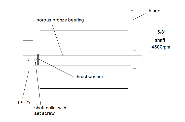

I hope you all will permit a question from a non-scientist seeking some practical guidance on a vintage table saw restoration.
I have a 1930s era table saw whose 5/8" shaft spins at 4500 rpm inside a porous bronze bearing that is lubricated with SAE 20 oil.
On the motor pulley side of the shaft, there is a shaft collar with set screw between the pulley and the bearing. This shaft collar prevents the shaft from making excessive lateral movements. But it seems to me to have drawbacks:
1) if the face of the shaft collar is not touching the bronze bearing, there is opportunity for some lateral play in the shaft, and hence some play in the blade; or
2) if the face of the shaft collar is touching the bronze bearing, there is considerable friction
Therefore, I thought that a self-lubricating thrust-washer could be inserted between the shaft-collar and the bronze bearing. The shaft spins inside the thrust washer, if I understand correctly. Am I going down the wrong path? If this makes practical sense, is there one type of thrust washer that would be better suited than another for this application? E.g. oil lubricated bronze:
http://www.mcmaster.com/#thrust-washers/=id6ev6
or PTFE/oil impregnated:
http://www.mcmaster.com/#thrust-washers/=id6fba
or bronze or graphite?
http://www.mcmaster.com/#thrust-washers/=id6ftv
Here's a crude sketch to orient you. And a picture.

Well, you could replace your bronze bushing with a double tapered roller bearing set. That would eliminate any end play without face contact, but it would be expensive and complicated. Perhaps you could start a thread in Materials and Chemical to ask for a suitable plastic to use as a spacer; I'm really not qualified to suggest one. The only thing that comes to mind is Delrin, but it has some problems of its own.

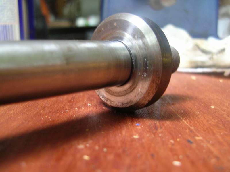

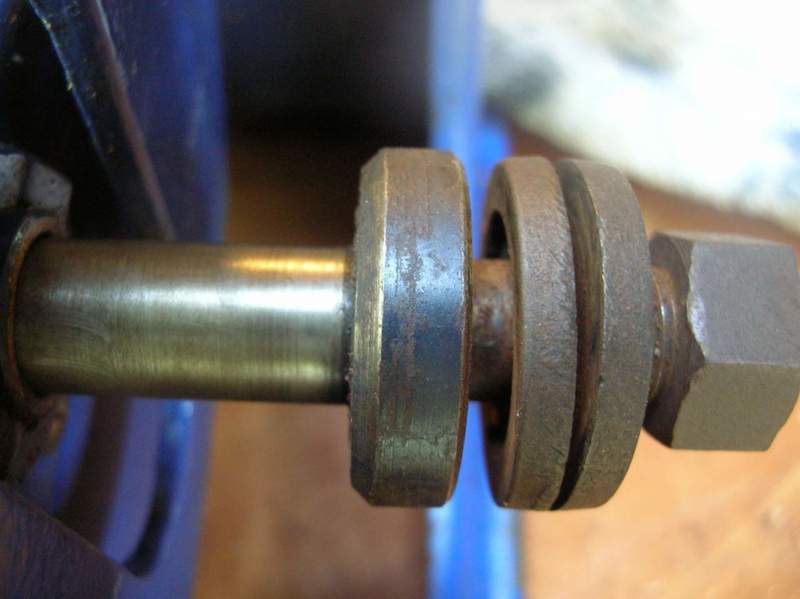

The porous bronze bearing is automatically lubricated with SAE20 oil from two tiny reservoirs above it, one near each end. They're about the size of a pencil eraser. The manual reads:
This tool is equipped with the new type bronze bearings which meter filtered oil to the moving parts. These bearings have invisible pores that become saturated with oil. The heat generated by the turning of the shaft causes the lubricant in the reservoir to automatically flow through these bronze bearings, thus lubricating the moving shaft. When the shaft is at rest, the oil is absorbed by the bearing.
I assume the oil moves out to the face of the bearing too, because on the blade side of the shaft, there's a chamfered metal collar that seems as though it could rest against the face of the bearing. See picture. I have it pulled away from the bearing so it can be seen better.
I'm wondering if something comparable to this chamfered metal collar should be used on the pulley side. Would the oil in the porous bronze bearing and a self-lubricating shaft washer be able to have face-to-face contact at 4500 rpm?
I do not want the shaft to have 1/16" of lateral play, 1/32" on each side. But maybe that was an acceptable amount of slop for small table saws back in the 1930s, and I'm expecting narrower tolerances than the design was capable of?

Would a needle roller thrust bearing placed between the shaft lock collar and the bronze shaft bearing work?
http://www.mcmaster.com/#needle-roller-thrust-bearings/=idj50q
You would probably need to spring-load the shaft somehow to maintain an end load on the thrust bearing. Trying to keep it loaded with a set screw adjustment doesn't sound very good. You need to maintain a minimum thrust load on the bearing as well as staying below the maximum load, otherwise the needles or balls can start to skid rather than rotate, leading to wear and/or overheating.
The fact that you can move the shaft with finger pressure when it is not rotating may not be the same situation as when it is being driven under load, with the belt tension providing a restoring force if pulleys try to move out of line. (But take care if you try to check this out when the machine is running, of course!)

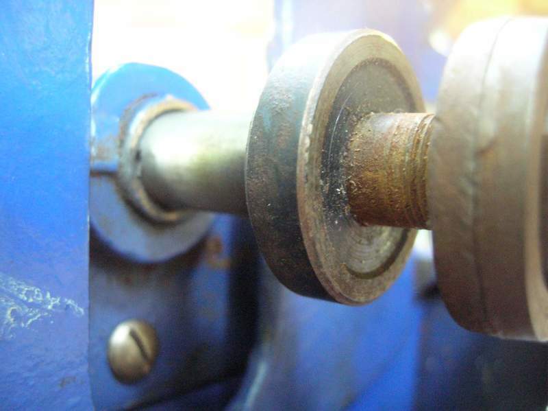

FWIW, here is a picture from a similar saw showing the original shaft collar between the pulley and the sleeve bearing.

Ignore that picture of the shaft collar with the set screws. I hadn't seen that saw in person. Turns out, it is a ball-bearing model, as you had surmised, which was offered in the same catalog year. The model I have has sleeve bearings only.

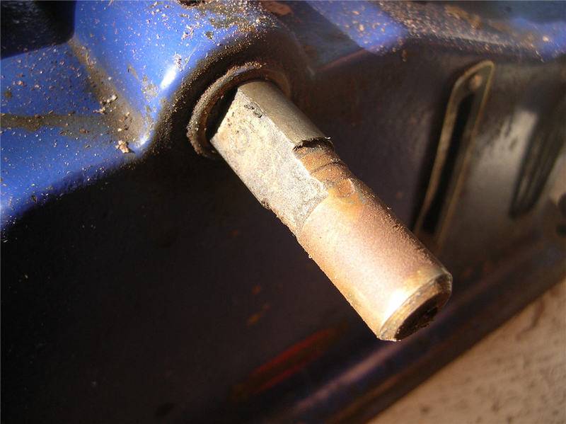

Here's a picture of the quasi arbor bearing that is mounted blade-side. You can see where it is worn where it has made contact with the face of the blade-side sleeve bearing.
My thinking is that even if I leave clearance between the shaft collar and the sleeve bearing, there will eventually be contact with the face of the sleeve bearing; so the root of my question is whether it would be better to have that contact be against something with inherent lubricity.

That makes sense. You don't really need a thrust bearing here, because if you are sawing straight, there isn't any signifcant thrist force. The thrust bearings in your links can handle end loads of up to thosands of pounds which is complete overkill.
What you want is a location bearing, to stop the shaft moving in either direction. A ball bearing is a simple way to do that. (Ball bearings can also take thrust loads if the ball races are cone shaped rather than cylindrical, but that's irrelevant for your saw).
