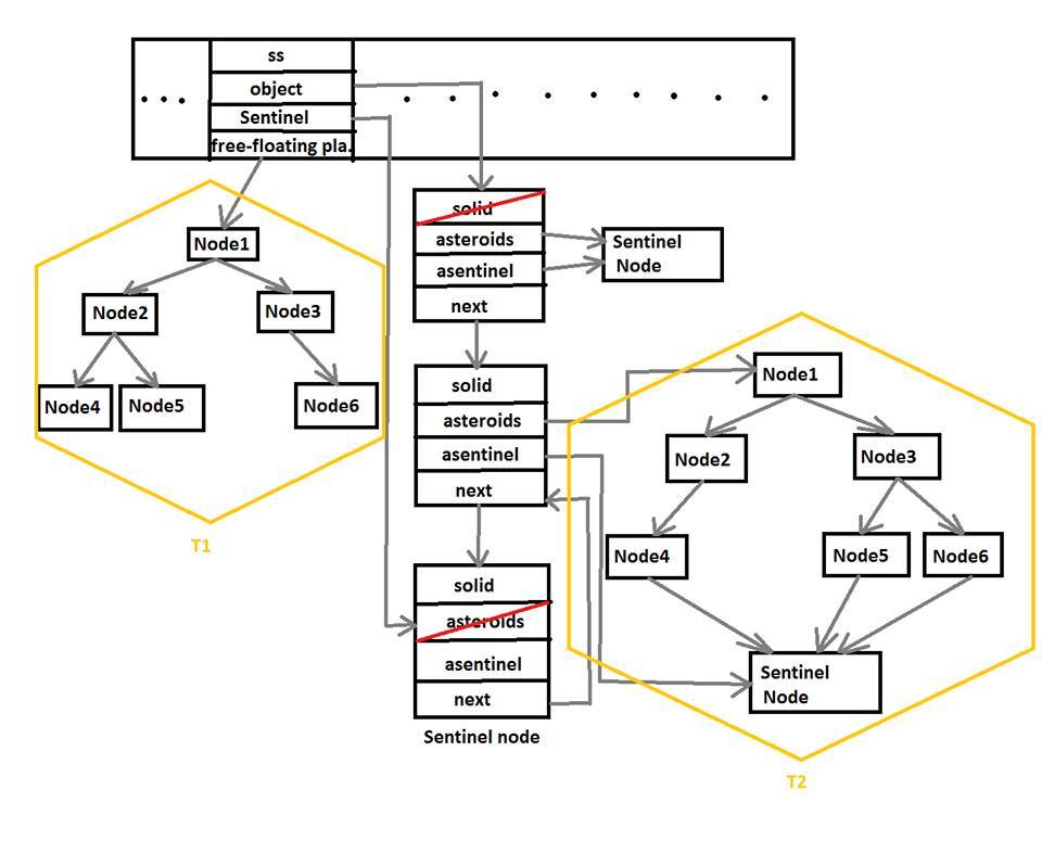

I want to write a function for the constitution of a star system "ss".
The new star system contains an empty list of planetary system, that means that in the list of the planetary system exists only the sentinel node, and the empty tree of the free-floating planets (ffp). The new star system should be inserted into the array of star systems(StarS). The complexity of the insertion should be $O(1)$.
The structures are the following:

What does it mean "in the list of the planetary system exists only the sentinel node"?? (Wondering) How could we do that?? (Wondering)
Technology news on Phys.org
mathmari said:
Is it correct?? (Wondering)
Hi! (Wave)
When you run it, does it perchance generate a segmentation fault? (Wondering)
A sentinel node is supposed to be a dummy node that you can check for when iterating over the collection.
That means that you have to create that dummy node, and that both the plasy and the Sentinel should point to it. The fact that they point to the same node means that the list is actually empty. (Nerd)

I believe you should create a dummy node with [m]calloc[/m].
Then you can make plasy and Sentinel point to this new dummy node. (Nerd)

Much better! (Happy)The calloc() should be done after the possible [m]return -1[/m].
Otherwise you're allocating memory without every freeing it, when there is no space in StarS. (Worried)
And instead of [m]if(Sfreep>=N)[/m] it's better to write [m]else[/m]. (Nerd)Either way, everything gets initialized properly now without segmentation faults! (Nod)

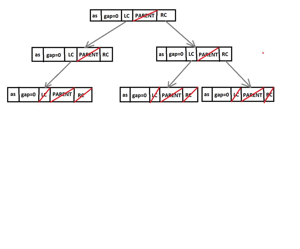

Then I have to write also an other function for the constitution of a new asteroid with identifier "as" at the planetary system "solid".
"gap" is the gap between the new asteroid and the object of the planetray system "solid".
The new asteroid should be added in the appropriate position, in respect of the "gap", in the tree of asteroids of the planetray system "solid".
The field gap, that corresponds to the new asteroid, contains the gap from the object of the planetary system in which in contains.

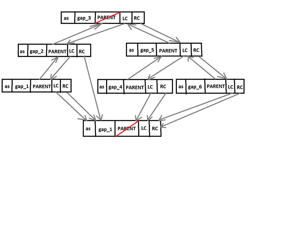

mathmari said:
Code:
void Insert(asteroid_t *p, asteroid_t *new, asteroid_t Sentinel_node) {
Shouldn't the Sentinel_node be a pointer? (Wondering)
Code:
   if (new->gap < p->gap) {
      if (root->LC == Sentinel_node)
         p->LC = new;
A Sentinel_node is supposed to go at the end of a linked list.
But it appears you have a binary tree? :confused:
I don't think a Sentinel node has a place in a binary tree.
And btw, shouldn't the Sentinel_node be linked to the end of the list? (Wondering)

I'm afraid this can't work correctly. (Worried)
If the insertion should be done at the head of the list, the head, which is [m]p->asteroids[/m], should be updated. But the function Insert() won't be able to do that, since you're passing a copy of the pointer to the function. (Sweating)
The same thing is true for the Sentinel, which needs to be updated if the asteroid is inserted at the end of the list. (Sweating)

The structures have the following form:
where T1 is the tree of free-floating planets:
and T2 is the tree of asteroids:
Aha! That clarifies what's going on. (Smile)
Hmm... it's a bit odd that Sentinel->next would point back in the list, isn't it?
It would make more sense if it were NULL. (Wasntme)
