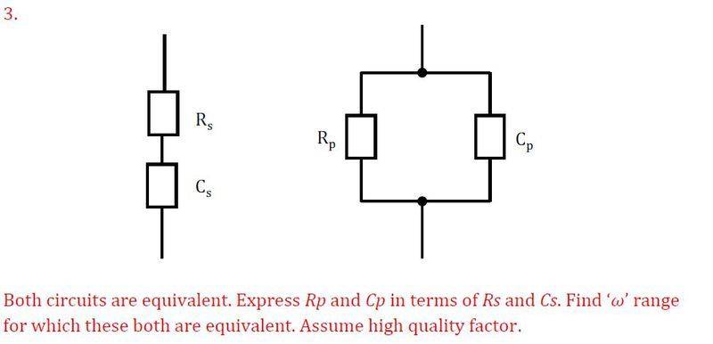

Series RC and parallel RC

Given : a series RC circuit with Rs and Cs and Parallel circuit with Rp and Cp...also given both are equivalent and Q-factor is high. Calculate the range of w for both circuits are equivalent.
pls help asap...
Determine the impedance of the second circuit, expressing it as a REAL component and an IMAGINARY component.

i got it till this..
Rs=Rp/(1+Q^2) and Cp=Cs(1+1/Q^2) assuming Q=1/wRsCs=wRpCp...but when it comes to finding the range of w I'm struck...
