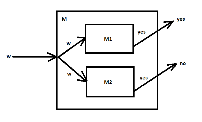

Let $A$ and $A^c$ be recursively enumerable. That means that there are TM $M_1$ and $M_2$ that semi-decides the set $A$ and $A^c$ respectively. We construct a TM $M$ that simulates simultaneously $M_1$ and $M_2$. $M$ accepts the input if $M_1$ accepts it and rejects it if $M_2$ accepts it. Since the input is either in $A$ or in $A^c$ exactly one of $M_1$ or $M_2$ will accept. That means that $M$ will always have the output either "yes" or "no", but will never have both.
That means that there is a TM that accepts $A$. So, $A$ is recursive. Is this correct? Could I improve something?
Technology news on Phys.org
Yes, this is correct. You may elaborate on "a TM $M$ that simulates simultaneously $M_1$ and $M_2$". How do you do this?
The input of $M$, let $w$, is given simultaneously to the TMs $M_1$ and $M_2$ as inputs. One of these two machines will halt. If the machine that halts is $M_1$ the TM $M$ accepts $w$ and if it is $M_2$ then the TM $M$ rejects $w$.
Is this correct?
Yes, it's fine.
