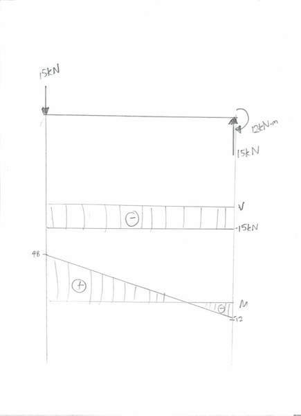

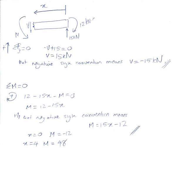

I've attached my sfd and bmd for a beam, i just need someone to tell me if its right.
the 15kN on the left side is a reaction force.
i've attached my working
