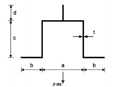

Hello guys, I have to calculate the shear stress in this figure.
The sizes are: a = 250mm, b = 100mm, c = 250mm, d = 150mm and t = 10mm.
The shear force working on it is Vcd = 39802.01 N (calculated before)
The center of the construction Nc is at 157.95 mm (from the bottom). (calculated before)
The moment of inertia (I don't know if this is the correct english term) I = 147258143.9 mm4. (calculated before)
The things I already calculated have been checked and approved.
The calculating of Tau1 is also correct but after that one it goes wrong...
Taui =(V*Si)/(b*I)
Si = Ai * zi, in which z is the distance from the center of gravity of that part till the center Nc.
I am not english from origin so my answer isn't in english but because it's math/physics you'll probably understand :). Otherwise I'll explain what I did.
I ordered the different parts as followed: 1 is the vertical top part. 2 is the large horizontal part (with length a). 3 are the two vertical pieces and 4 are the horizontal pieces at the bottom.

Please put yourself in our place. We have no idea what the loading on this object is. Please describe the loading.
Sorry I totally forgot haha. The thing you are looking at is a cross section of a beam which has a shear force in it. The loading is the shear force which works downwards with 39.80201 kN or 39802.01 N.
The load is centered so it works downwards in the middle (but it doesn't change in the formula so you can assume it constant at 39.8 kN)
Does this make it better understandable?
