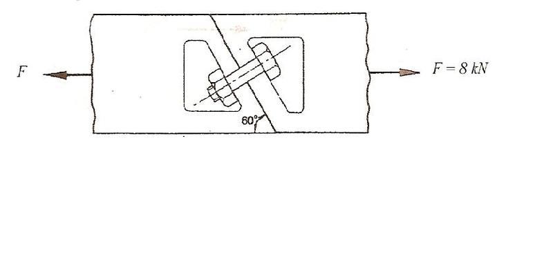

The material for the bolt shown in the angled joint above has an ultimate tensile strength of 500 MPa and a shear strength of 300 MPa. The diameter of the bolt is 8 mm. Determine the factor of safety in operation.
Shear stress= 5,5 . cos 60 (pi . 8 . 2/4)
= 0.0547kn
= 54.70 mPA
Shear Fs= 300/ 54.7 = 5.48
b) Tensile Stress = 5,5 . sin 60 (pi . 8. 2.4) = 94. 7 Mpa
Tensile Fs = 500/94.7 5.27
Is this correct?

You have considered tension and shear independently, but actually they are acting together. To solve, you need to know the shear/tension strength characteristic. The graph of shear stress/ ult shear stress versus tensile stress/ ult tensile stress is sometimes assumed linear, but that is a 'safe' assumption. The experimental results were used to determine at least the relationship for the eurocode and is approximately parabolic or elliptical (I can't remember which without looking it up in ec3)
