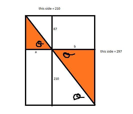

I would interpret the question like that too, but then feel worried because that would be too simple. I'm confused as to what this question is asking exactly...
Yeah..I have same worry
Are you sure one of the other edges isn't closer? I'd think that point will be closest to one of the long sides of the paper.
Can you please draw how you think it should be!
You can't just assume that its 87, you need to know something about the other two lengths.
Daw a rectangle. Draw a diagonal through it. Draw 2 lines, perpendicular to each other and parallel to the sides, intersecting at a point on the diagonal.
so you should be looking at this: (see attached)
How do the two triangles relate? You need to try to find a relationship between a and b, and solve for them. Once you do that, compare their values to the known sides.
wow..ok the orange triangles have the same angle, but still can't find how to get a.
I think i get it.
Tan O = 297/210 = 1.414
O=54.73 degrees
Tan O = 87/a
a=87/tan O
a=87/1.414
a= 61.53mm ?

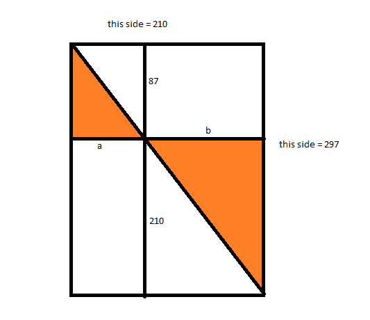

D H: Sorry! Didn't mean to, like I said I was tired.
Chawki: Exactly, nicely done. You can do it in another simpler way, too, not involving any trig functions like tangent, sine, or cosine. Can you figure out how?
Nope o:) Give me a small hint :tongue2:
How about something named for a Greek mathematician? :wink:
ah yes Thales :blushing:
a/210 = 87/297
a=61.51mm
nicely done :)
