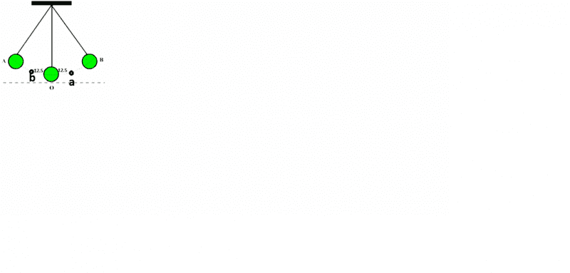

A particle performs S.H.M. with amplitude 25 cm and period 3 s. The minimum time required for it to move between two points 12.5 cm on either side of the mean position is ?
##y##=##a## ##sin####w####t##
Solution is
##y##=a sin ##w## t
6.25=25 sin##\frac{2π}{3}##t
t=0.25
I don't understand why would we take y=6.25?
I don't understand what " the minimum time required for it to move between two points 12.5 cm on either side of the mean position is " it means?
I take it as total time required to go from +12.5 to mean position and then from mean position to -12.5 cm.
it will take ##\frac{T}{4}## time to reach +a from mean position i.e to reach 25 cm from mean psition
then it will take T/8 time to reach mean position from +12.5 cm . And it will take another T/8 time to reach -12.5cm from mean position hence total time T/8 + T/8 = 2T/8 = 0.25 T
Right?

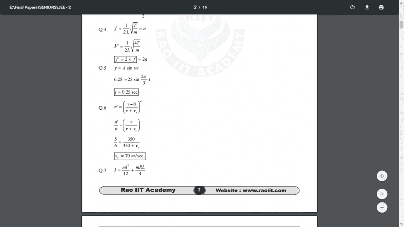

I was practicing questions based on SHM. I found the following test
http://career.webindia123.com/career/entrance/ques.asp?sub=physics&groupID=9&course_name=&page=2
Look at question number 7.
Then I started searching for it's solution and I found this
http://www.raoiit.com/MH-CET-2015-Sol/Medical-UG%20MH-CET%202015%20Question%20Paper%20version-11.pdf [Broken]
Jump to question number 5
Then I looked for it's solution and finally I got
http://www.raoiit.com/MH-CET-2015-Sol/MH-CET-%202015-Answer%20Key%20and%20Solutions%20version-11.pdf [Broken]
See question number 5.
For some reason I couldn't access the last two links. Nevertheless I tried to work out the problem the way it should be done; it turns out to be the correct answer, which is different from the first solution t=0.25 s.
So, what about your own attempt? Have you checked if it's correct?
Likes gracy
You tell me. Am I correct ? that's what my OP is all about.
At the bottom end of the first link in post #5, there is a "submit" button you can use to check your answer, you don't need to answer the rest of the question to see your result of problem no. 7. Your answer is 0.25x3 s = 0.75 s which is not among the choices.
That's not true for non-linear functions, such as sinusoids.
Imagine your particle starts from the mean position at t=0. Then the displacement equation looks like ##y(t) = 25 \sin \omega t##. Find the time at which the particle reaches ##y=12.5## for the first time.

gracy said:
I don't have to include time taken to travel from mean position to 12.5 i.e time I just calculated.

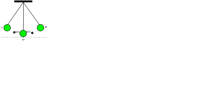

You do, the time ##t## you just found will be used to answer the question. Just use the picture you posted in post#1. What you have now is the travel time from the mean position to +12.5 cm. What is the travel time between the same points for the reverse direction?
Likes gracy
Yes. I knew it. It will be still 0.25.
Yes, and the travel time from the mean position to -12.5 cm is?
Likes gracy
Then I need to find time taken to travel from mean position to -12.5. I think it will be again 0.25. Therefore total time would be 0.25 + 0.25 = 0.5 s
Yes that's the correct answer.
