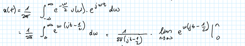

Find the CT signal associated with CTFT:
Given the CTFT X(ω): 1638042527872.png
and here are my solution to find CT signal x(t) associated with the given CTFT , but i got stuck at the limit part
BvU said:
FInd any hints in a table of FTs ?
Oh, my professor never mention this, i will check this and see
Thank you

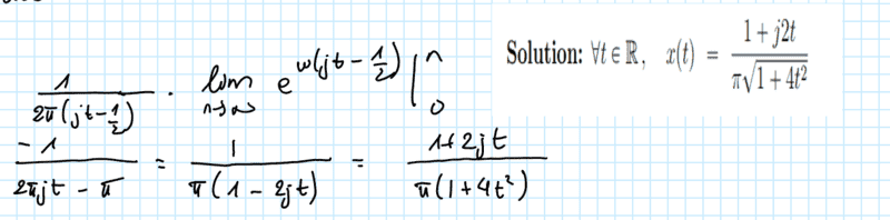

##\exp(n(jt-1/2))-1\to -1## as ##n\to \infty## since ##\exp(jtn)=\cos(tn)+j\sin(tn)## and ##\exp(-n/2)\to 0## as ##n\to \infty##.
Yes i have tried this before, but it didn't match the solution that my professor gave, that's why i ask in here to check
