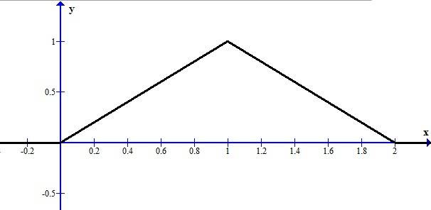

x(t) = t, [tex]0 \leq t \leq 1[/tex];
x(t) = 2-t, [tex]1 \leq t \leq 2[/tex];
x(t) = 0 ,otherwise.
I want to draw this signal, and I have something similar to this
Is that correct? Also this is not periodic right? I just want to be sure 100%
Thanks!

Looks good to me.
Ok thanks a lot;)
