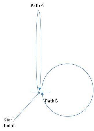

Two twins set off from the start point at the same time, leaving me behind at the starting point. (See attached diagram.)
They both travel at the same speed say 0.5c, both travel for the same distance, (eg total distance traveled not distance from the starting point.) but take different paths.
Path A is basically a straight line round trip and Path B is a circular path.
So I guess the questions would be:
a) Would I see them both return to the starting point at the same point in time?
b) Have they both aged the same amount when they returned?
c) Would they have aged at a different rate than me?
Yes to all three (and to the last, they have aged less than you when they return).
