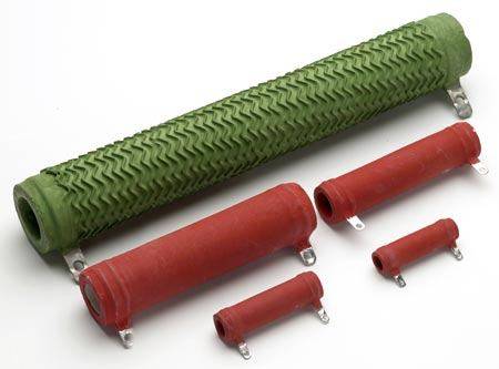

Let's say I have some wire with known constant resistivity and I make a coil out of it. Can this schematically be considered a resistor in series or parallel with an inductor, or neither? The voltage drop across the resistor would have to always be the same as across the resistor, which suggests parallel... Any thoughts?
It is a series connection. Power resistors used to be produced that way.
Here are some power wirewound resistors:
Likes davenn
there is only 1 resistive component (only 1 component, period), there isn't anything in parallel with it, other than the power source ( which doesn't count in this case)
the wire in a coil is still going to be a resistor as shown in the pic's that Svein has shown ... particularly the top one.
BUT because it is a coil it is going to have significant inductanceDave

Alright... So if we put an AC voltage across the circuit, it can be analyzed using an impedance of ## i\omega L + R ##, where L is the well known inductance of a coil?
Also, how would you find what the theoretical capacitance of this setup would be?
OMG! That would be pretty hard and would involve knowing the exact dimensions of the device, thickness of wire and pitch of helix, how it's actually mounted in the circuit (and operating frequency, of course). Best way to find it would be to by measuring the resonant frequency - a network analyser would give you a 'squeak' of the device in circuit and you would get a wiggle on the impedance response around the resonant frequency. In the old days, Marconi used to sell an instrument (can't remember the name but some PF member is sure to know) which could find the resonance and give you a direct reading of component values, as I recall. Very useful and practical for the RF Engineer before they invented the modern alternatives.
