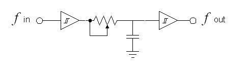

I attached a proposed diagram for the delay line circuit. Would this do the trick?

That diagram has a series C and shunt to ground R,
whereas for a low-pass ('integrator') type delay
you'd want the series R feeding into a C
which is shunted to ground with the RC junction
going out into your schmitt trigger.
Then your R (being in series) controls the
current flow into the cap, and the RC time constant
slows the rise (and fall) of the pulse propagating
from the R's input to give the output whenever
the C is sufficiently (dis)charged.

PS use a relatively large R value so that you don't
over-load the output drive capability of your
logic buffer that's driving the RC circuit. Most
kinds of digital logic can drive 50k ohms into
a short circuit pretty well; I'd stay above 15k
anyway. It shouldn't be a problem since you'll
be able to do something like use capacitors around
18pF range with a 10k
resistor in series with a low capacitance
10k ohm pot and get a good range of
sub-to-near-microsecond timings depending
on the particulars of your parts.
Use care with the layout and wiring (keep all
components as close as possible together with
insignificant amounts of interconnecting
distance / wire), and you should have no real
problem with the capacitance varying too much
with environmental effects. Actually for this
kind of thing it's common to just solder the
components together by their own short-trimmed
lead stubs, and put the whole thing in a metallized
enclosure to prevent EMI and environmental
electronic or mechanically coupled disturbance.
If you use an 'identical' circuit on all phase leads
you don't even have to use such small values of
capacitance to minimize the absolute delay,
since the only thing relevant to you is the
relative delay between the three phases, so if
they all had a nominal delay of even more
than 1uS it's OK since it's the incremental
variance of delay due to the adjustment that
matters. Given that, you could increase the
R and C if desired as long as you have the
+/- delta range you want whatever the
center delay value is.
But working with 18pF capacitance in a well
constructed delay circuit shouldn't be problematic,
you just don't want to try it on a prototyping
board or with sloppy wire wrap / sloppy large
distance soldering.

i agree with xez, circuit should look like this.
im not sure which capacitors are the most suitable for the circuit, as they all tend to have variations over temperature. But with a little search i found Murata ceramic capacitor type C0G which is extremely stabile over temperature.
http://www.murata.com/cap/nproduct/index.html#11
But if the circuit is to be within a decent temperature range, normal XR7 type ceramic will work fine.

I just tested out the circuit using a 74LS14 inverting Schmitt trigger buffer, a 680pF cap, and a 1KOhm 15-turn pot. with an input clock frequency of 100kHz, I was able to shift the output wave between 0 and 1 uS with 1 nS resolution! The surprising thing was the stability of the output waveform. I was viewing this all on a 100MHz dual-channel scope that was triggered off of the input frequency.
Works like a charm, thanks!
