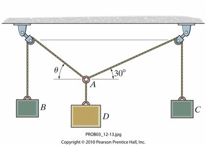

Hi everyone, I've been stuck on this relatively very simple problem for quite a while now and even after solving I'm still getting two answers while the book only lists one.
Question: If block D weighs 300 lb and block B weighs 275 lb, determine the required weight of block C and the angle (theta) for equilibrium.
So I did the usual since it's in equilibrium then Fx = 0 and Fy = 0.
So, Fc(cos30) - 275(cos[itex]\theta[/itex]) = 0
and Fy(sin30) + 275(sin[itex]\theta[/itex]) - 300 = 0
Then after finding cos[itex]\theta[/itex] in terms of Fc and substituting, you get this equation: 158.7cos[itex]\theta[/itex] + 275sin[itex]\theta[/itex] = 300
The answer listed is: [itex]\theta[/itex] = 40.9 and Fc = 240lb
Can anyone please tell me how to solve the equation above? I tried using the trig identity (square of cos plus square of sin = 1) but I got two answers, one was similar to the book ([itex]\theta[/itex] = 40.9, and one was [itex]\theta[/itex] 79). Thing is, when I use the second value I got (79) in the equations above, it works for all.
I'd appreciate some clarification on this problem! Thanks.

Both angles are correct.

ehild, so then there are also two possible weights as well, correct?

Yes, of course. There is less weight for the greater angle.

Yes the two answers for the angle are correct and the less weight mentioned by ehild is 59.9lb.

The weights are acting in the Y-direction (i.e. vertically).But here we are examining the equilibrium at point A and the equations in the first post are correct.
