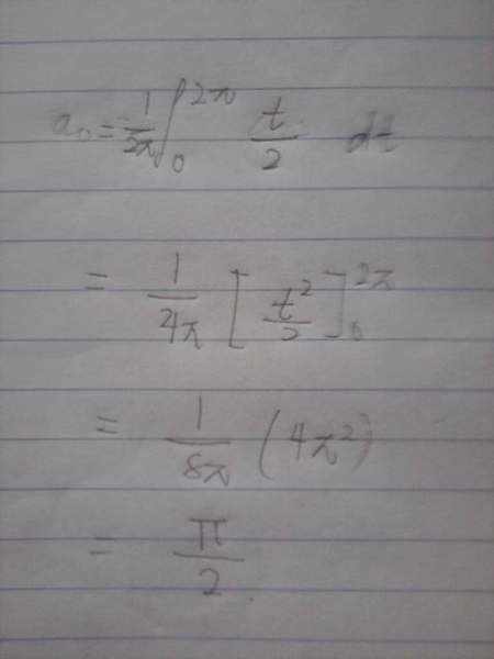

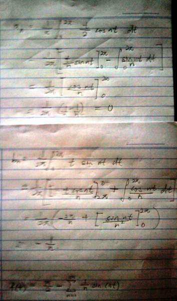

A periodic function of period [tex]2\pi[/tex] is defined by:
[tex] f(t)=\frac{t}{2} , 0<t<2\pi [/tex]
Show that the trigonometric Fourier series of f(t) is given by:
[tex]f(t)=\frac{\pi}{2} - \sum_{n=1}^{\infty} \frac{1}{n}sin(nt)[/tex]
I've gotten [tex]\frac{\pi}{4}[/tex] for constant C instead of [tex]\frac{\pi}{2}[/tex]
What have you done so far, show us your working.
Since function is odd, An = 0.
Bn = [tex]- \frac{1}{2\pi} \frac{2\pi}{n} = -\frac{1}{n} [/tex]
Thats for now...

So you compute te A_n's and b_n is the usual way, what you have done with this?

Hmm, I am at a loss.
